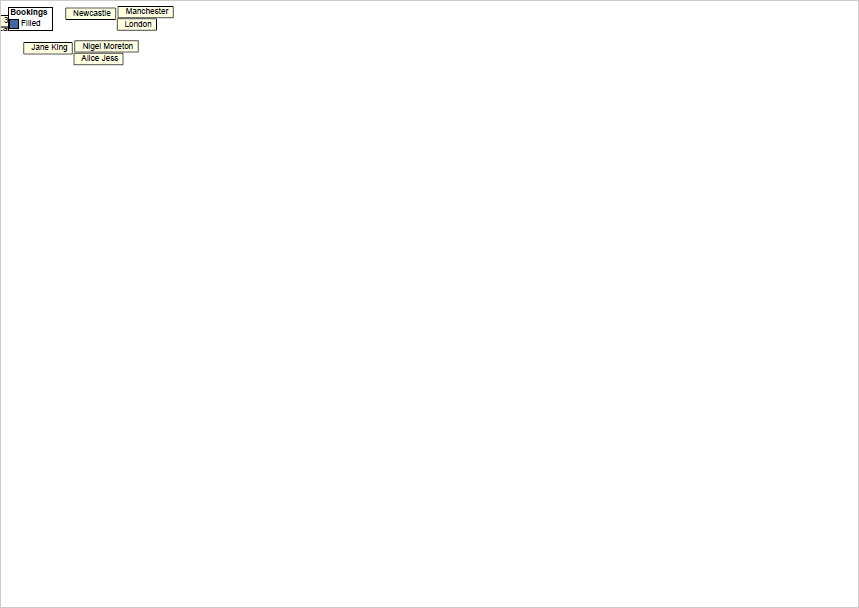

The chart looks fine in the previewer but when I print it renders the dashboard into a small square top left of the paper.

Using a virtual pdf printer I get this result with TeeChart v2016.18 that seems to be what you are reporting:

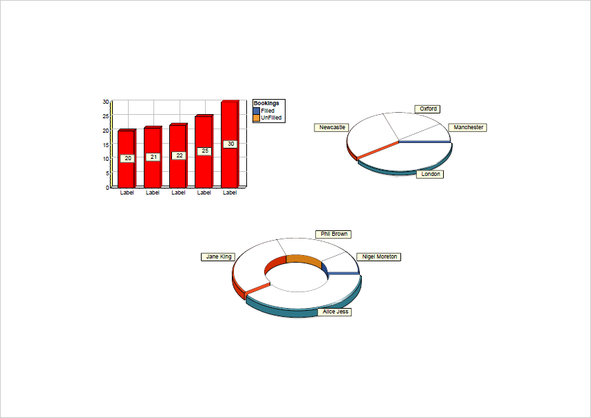

However, with the current sources I get this:
Which is not perfect because the gradients aren't supported in the export to pdf, but it works much better.
So the next maintenance release should fix this issue.
