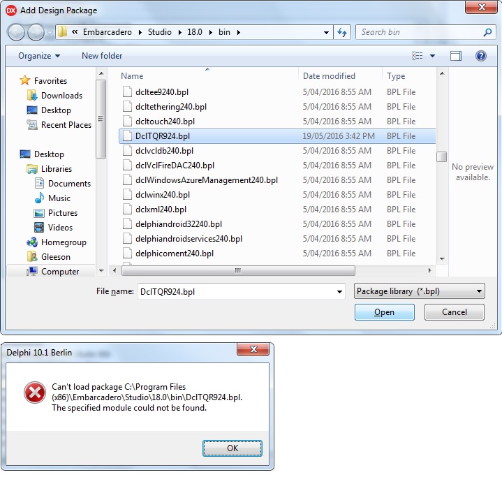

I noticed that the files you gave me and the ones that the TeeChartVCLFMXStandard-2016.18 setup are different for the quick report side.
eg... installed are dclTQR924 vs the new ones from zip are dclTee9QR506D24 ???
I copied the pre compiled files to relevant locations as per instructions also made sure paths are set.
It comes up with specified module not found on package install.
I recompiled the files from the zip which did so with no errors and then copied them again and same error msg as above.

Could you please copy the exact error message here?Carl wrote:It comes up with specified module not found on package install.

See attached image.
This came up when i followed the instructions. I double checked what i did and could not see where i might have failed.

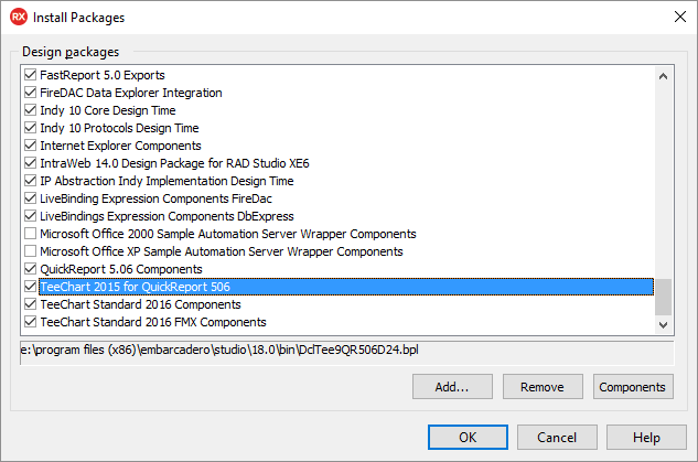

The packages Sandra attached here are named DclTee9QR506D24.bpl & Tee9QR506D24.bpl. Sandra tested them with TeeChart Standard v2016.18 packages for Quick Report 5.06 that we understand is the same environment you use. Could you please try with them?

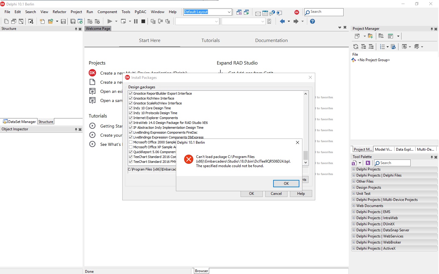

Sorry i uploaded wrong error msg, if you scroll down the image you will the error msg. This was using the package that sandra had a attached.
I checked the modules required within the package and made sure those where available in the Library paths this is 32bit atm. once all is good i will upgrading it to 64bit.

It works for me: Are you running the IDE with enough privileges (run as admin)?

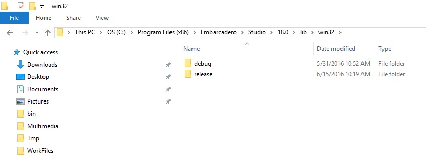

I am still getting the "Specified module not found" msg. I am uninstall teechart and trying again. I do have a question about the paths though as i follow the sheet i see that i need to add it to lib. That is ok however see attached. your documentation may need updating. I even got to the point of adding it in the lib directory plus the 2 sub directories. and still no joy.
- Library Path.jpg (38.97 KiB) Viewed 86653 times

Ok i have removed all the files and cleaned out folders. started afresh. I both tried using the recompiled files you send me and recompiled the units in it.
Neither worked and the msg displayed was "Specified module could not be found".
When i recompiled it it compiled without any errors, i even tried to then use the install function at that point for the design time module and still go the "Specified module could not be found" error. I checked the requires dcp files to make sure they were there and in a path that Berlin can access. They were all accessible, is there other modules that i need to look for ?

The error appearing when the package is being loaded usually indicates it includes references that can't be resolved. Since you can build the packages yourself without errors, I would assume the references in the packages must be fine.
The only I can think on:
- You may be loading the IDE without enough privileges: Try to open it with "run as administrator".
- The IDE may be finding a different bpl with the same name somewhere in your disk. I'd search for that (reference here).
Do you have a second machine to check the packages?

No dont have a second a machine to try.
Yes i am running as admin, i double checked to make sure.
and made sure that there is only one bpl available too.
it is a very odd problem.
