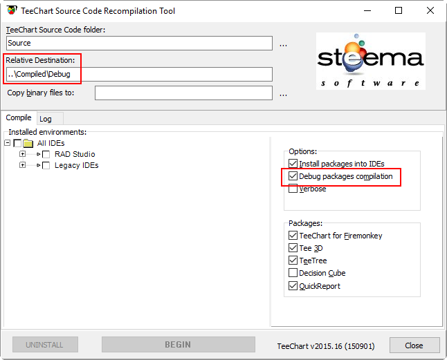

Post by Yeray » Fri Apr 29, 2016 3:42 pm
Have you tried running TeeRecompile twice, one for Debug:
And one for Release:
Then you could set the paths in your IDE to take one or the other depending on the "Build Configuration".

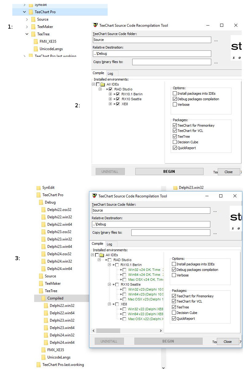

Maybe I was not clear enough, so here is what I do:
1: To start from scratch I deleted all the output directorys (see Explorer tree)
2: First I compile the debug-version (this is necessary because otherwise you end up with TeeTree compiled in debugmode(!)). In Addition to your suggestion I do not install this to the IDE (unchecked that option)
3: I run the compilation and that results in the Explorer-tree shown in the picture. Please not that - while the TChart-Library is compiled to the directory I choose (..\Debug) - the TeeTree - sources are compiled to a hard-coded path called "compiled" (gray mark under the \TeeTree).

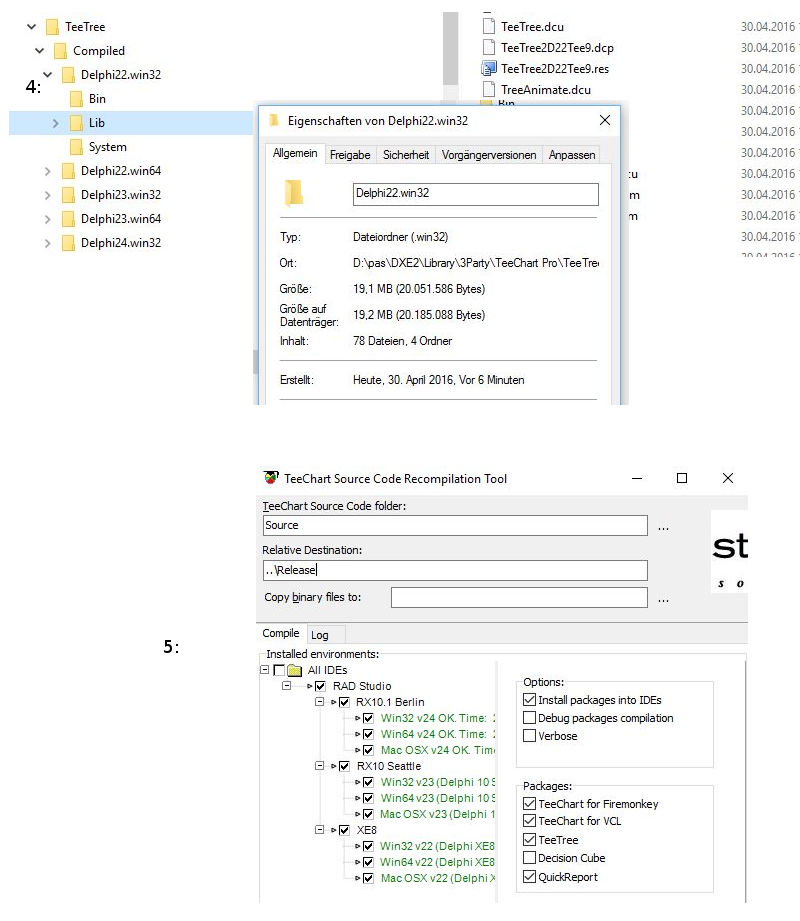

4: To clarify that I expanted that directory and made a screenshot of that path (..\TeeTree\Compiled) and its 19.1MB in size)

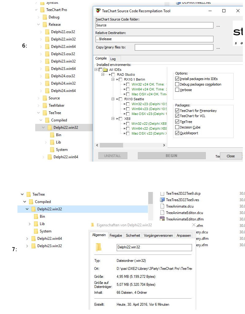

5: Then I change settings to my "..\Release"-path also this time the libraries get installed to the IDE (and debug is checked off)
6: After compilation in the TeeChart Pro directory an additional \Release-path is added BUT if you look at TeeTree below, there is just that harded-coded "Compiled" sub-directory! (This is the reason why you end up with a debug-version installed if you do not compile that version after the debug-version)
7: To be sure I deleted the TeeTree\Compiled sub-order and repeated compilation, then I made the last screenshot. Now the "Compiled" path is back and is 4.95 MB in size.
