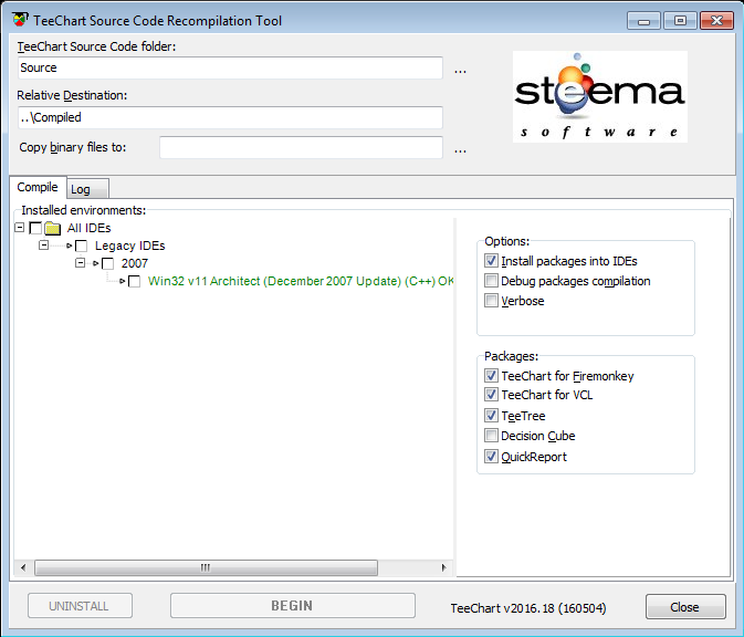

I used the TeeRecompile to install and it appeared to run through OK into:
C:\Program Files (x86)\Steema Software\Steema TeeChart Pro VCL Source Code 2015.16

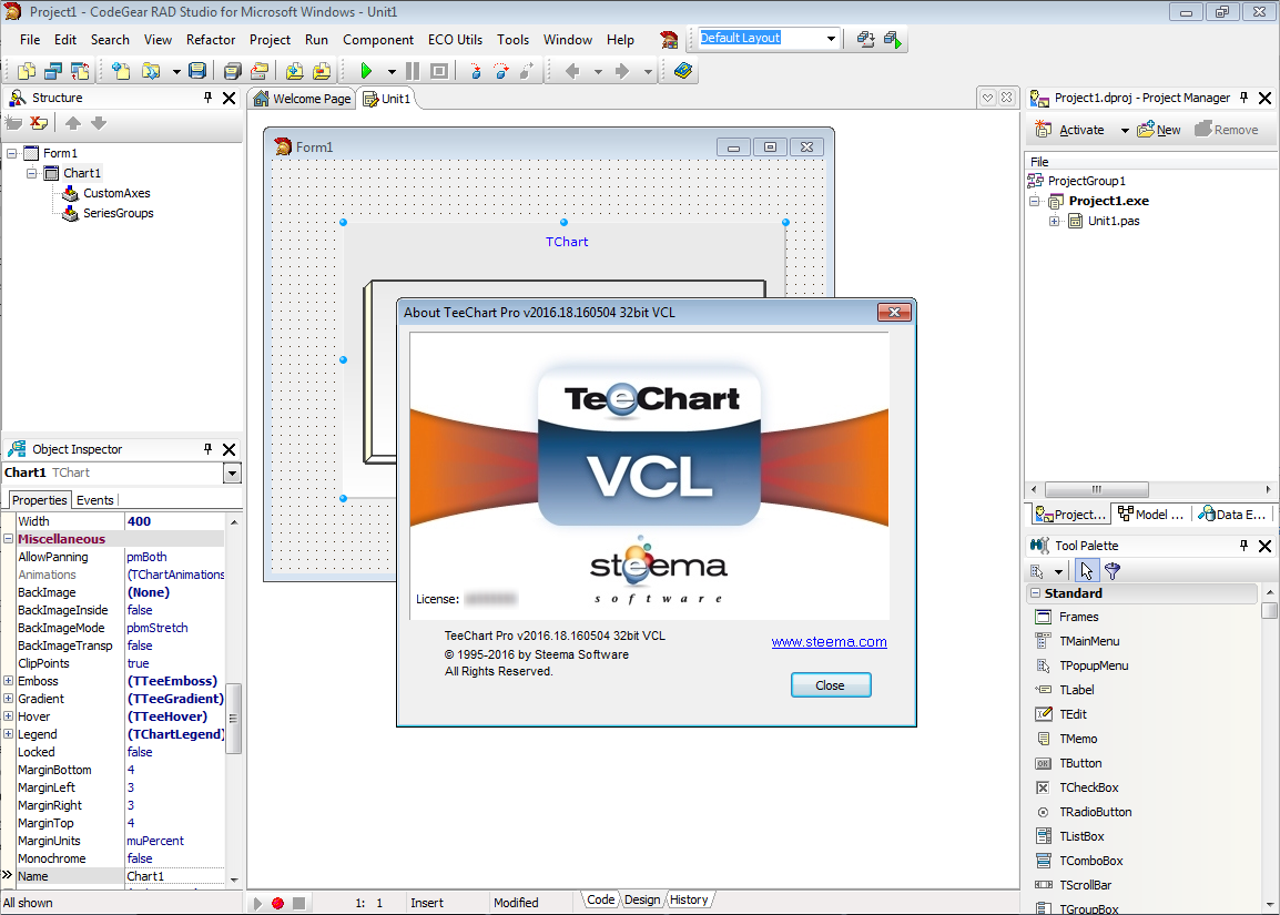

I've just tried TeeChart v2016.18 Source Code version (TeeChartVCLFMXSOURCE-2016.18.exe) in a Virtual Machine with just RAD 2007 installed and it seems to compile and install correctly:
The installer you downloaded may be corrupt so you could try downloading it again. Another possibility (the most probable IMHO) is that your IDE could be broken so I'd suggest you to repair/reinstall it.

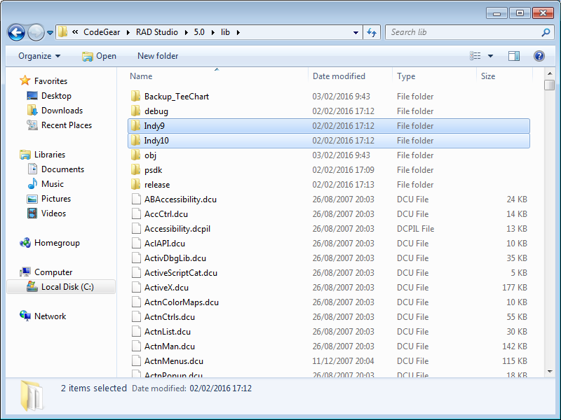

Indy 10 comes with the IDE, and I see it installed in the virtual machine I used to test this:
Have you installed Indy separately?

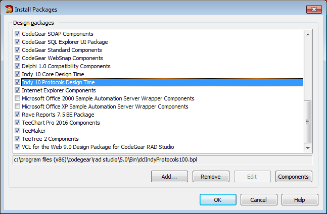

Post by OSNick » Mon Aug 22, 2016 9:59 am
If I remember correctly D2007 came with Indy 9 and for some reason we had to upgrade to Indy 10.
My 'Install Packages' screen looks the same except that the bpl at the bottom is C:\Users\Public\Documents\RAD Studio\5.0\bpl\dclIndyProtocols110.bpl
I also have the Microsoft Office 2000 Sample Automation Server Wrapper Components ticked.

OSNick wrote:If I remember correctly D2007 came with Indy 9 and for some reason we had to upgrade to Indy 10.
The RAD 2007 installation I have in a virtual machine is completely clean and I see both Indy 9 and Indy 10 packages, but Indy 10 packages are the installed into the IDE.

OSNick wrote:My 'Install Packages' screen looks the same except that the bpl at the bottom is C:\Users\Public\Documents\RAD Studio\5.0\bpl\dclIndyProtocols110.bpl
The path "C:\Users\Public\Documents\RAD Studio\5.0\bpl" exists in my virtual machine, but it's empty.
OSNick wrote:I also have the Microsoft Office 2000 Sample Automation Server Wrapper Components ticked.
I can activate it but this is how it was for me by default.
Anyway, I don't think it can affect TeeChart.
