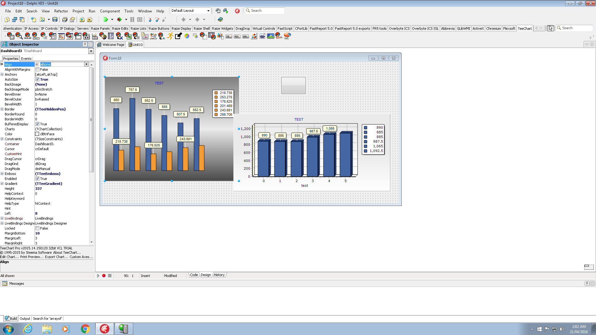

How to configure a bar chart in Dashboard to display the bottom label like the one in Tchart? I couldn't do it in design time and also run time.

Do you mean the footer?
  Chart1.Foot.Text.Text:='test';
