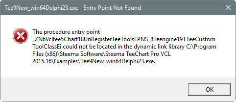

Now I am trying to run Start / All Apps / Steema TeeChart PRO VCL / New Features Demo 64 and get the following error message:
Error New Features Demo.jpg (45.67 KiB) Viewed 25948 times
What to do?
Mark

Softdrill NL wrote:I removed everything (Control Panel / Uninstall), manually removed the remaining folders & content in C:\Program Files (x86) and used CCleaner to clean remaining registry keys. Rebooted the machine, installed Binary, installed Source and ran TeeRecompile (successfully).
This sounds as the appropriate way to proceed.
We use to recommend to run TeeInstall.exe to uninstall a version from the IDE (binary or compiled sources) instead of fully uninstalling the program. If you run TeeInstall.exe and no TeeChart Pro is found in the IDE it continues in install mode.
So you can uninstall&reinstall a version without having to run the full installer and without having to re-register the product.
Note we also recommend running TeeInstall and TeeRecompile "as administrator" to be sure it will have the necessary rights.
Softdrill NL wrote:Still no integrated help in Seattle IDE... :(
If you don't find a TeeChart.chm file at the "Help\Doc" folder in the IDE, you can try put there the .chm from here.
An alternative is to use the online docs here.
Softdrill NL wrote:Now I am trying to run Start / All Apps / Steema TeeChart PRO VCL / New Features Demo 64 and get the following error message:
I'd suggest you to try this:
- Run TeeInstall.exe from the binary installation (Delphi23 folder) "as administrator". It should run in uninstall mode.
- Run TeeInstall.exe from the binary installation (Delphi23 folder) "as administrator". It should run in install mode.
- Run the New Features Demo 64. Does it run?
- Run TeeInstall.exe from the source code installation (Compiled\Delphi23.win32 folder) "as administrator". It should run in uninstall mode.
- Run TeeInstall.exe from the source code installation (Compiled\Delphi23.win32 folder) "as administrator". It should run in install mode.

Ran the first uninstall/install (binary) and New Features Demo 64 ran, but no source code available with examples. :(
Ran second uninstall/install (source) and get the same error message again:

Hello Mark,
I did the same thing here and found no problems.
Are the TeeChart packages modified in your Source code version?
