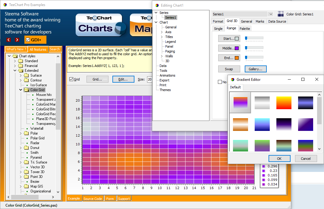

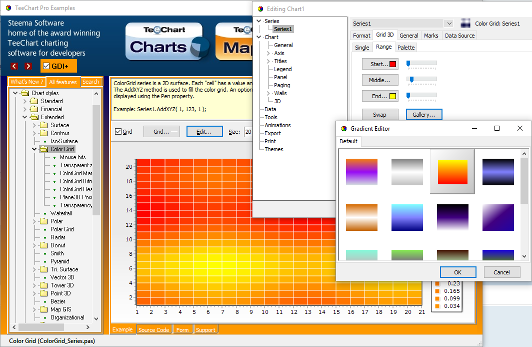

sde wrote: The Range has a "gallery" but when I tried to use that, nothing happened to the colors in the grid
In the ColorGrid example in the Features Demo, if I go to the Range tab, I can change the colors using the gallery. Ie:

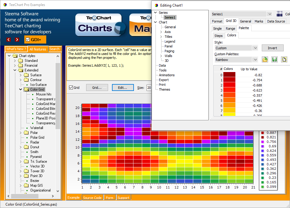

sde wrote: However, if you use a custom palette, the step size does not appear to work.
It seems to work for me. Ie, choosing Rainbow custom palette with the default 32 and 15 steps:
