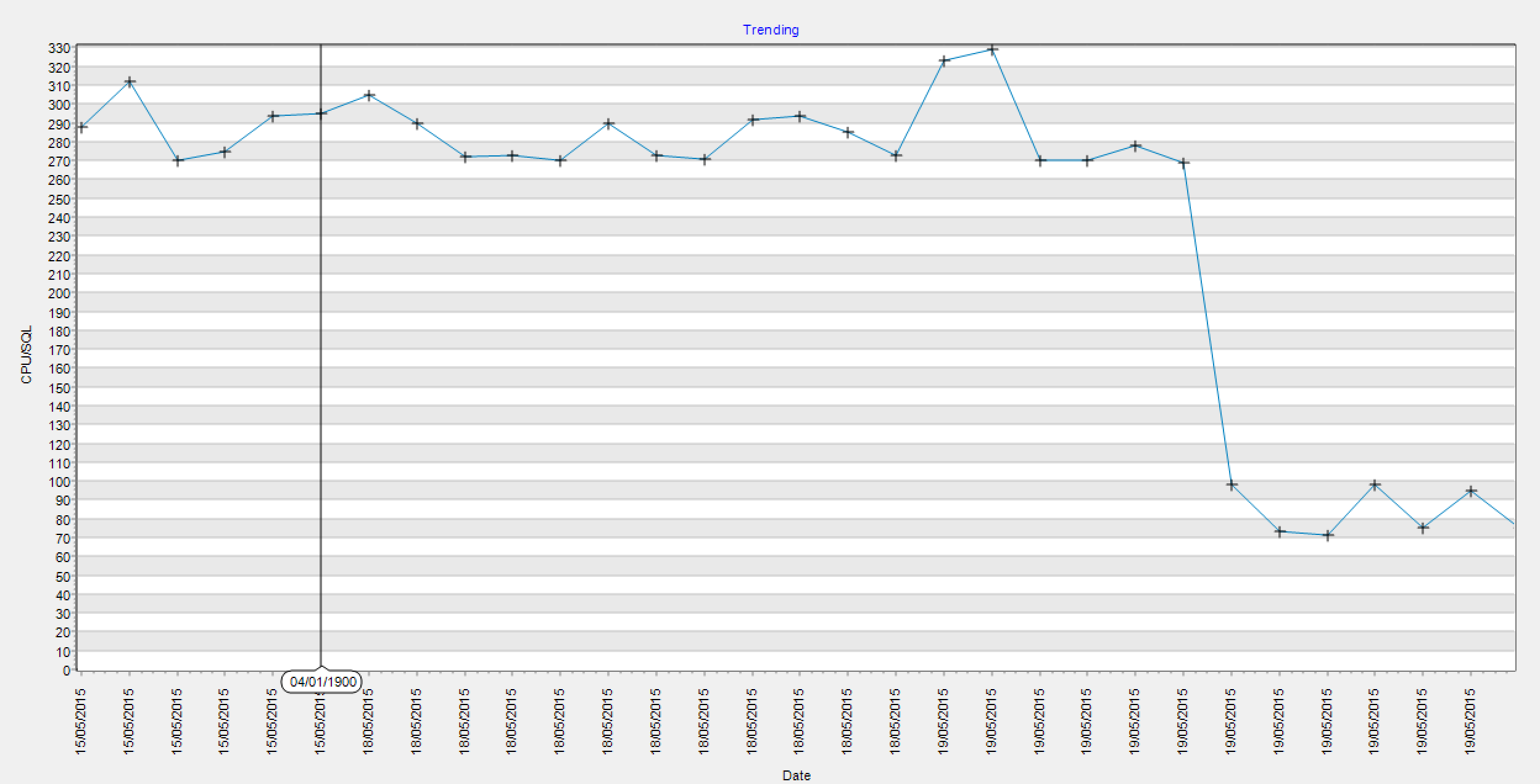

With the Cursor Tool, I have a vertical cursor set. I want the annotation callout to show the X-Axis value, which is a Date. The Series is built from an ADO SQL datasource. The main X-Axis shows the retrieved Date values correctly, but the Annotation on the Cursor never shows the X-Axis Value - it always starts at 30/12/1899 for the left most mark and increments by 1 day for each mark. The attached screenshot shows an example - you will see the X-Axis ranges from 15/05/2015 to 19/05/2015, but the Annotation shows 04/01/1900. How can I get the annotation to show the X-Axis date value?

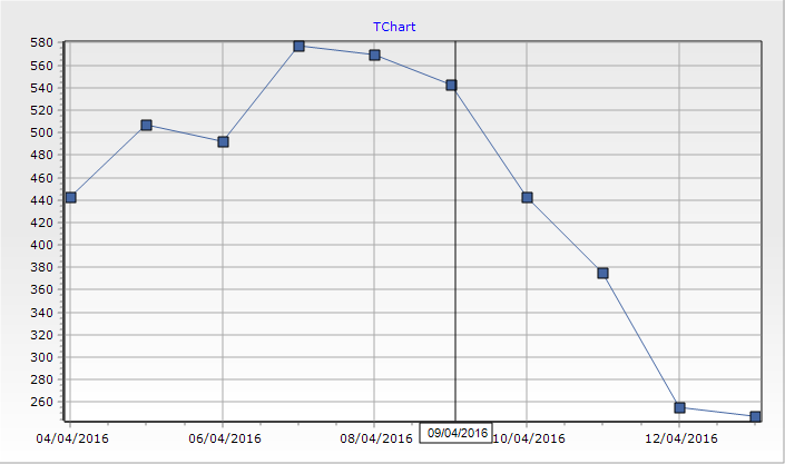

I've created a new TChart with a TLineSeries with pointer active and some datetime sample values; I've added a TCursorTool to the chart and activated its Annotation.
It seems to work fine for me here:
