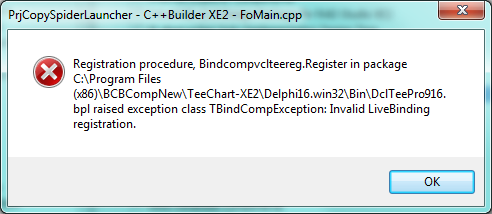

After the installation, when selecting the "TeeChart Pro 2012 VCL Components" in the "Design Packages" list of a test project, I receive the following error message:
Registration procedure, Bindcompvclteereg.Register in package
C:\...\Delphi16.win32\Bin\DclTeePro916.bpl
raised exception class TBindCompException: Invalid LiveBinding registration.

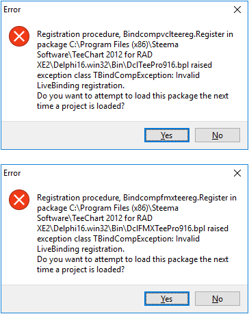

I installed TeeChart Pro v2012.07 and the first time I opened the IDE (always as admin), I got the errors you reported:

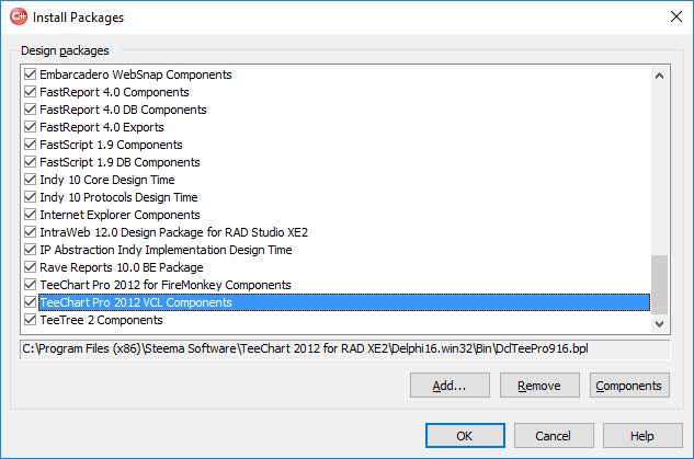

After replying "Yes" to both messages, the IDE loaded. Then I could enable the components without problems on the list of packages:

Sorry, but I didn't have the same luck as you.

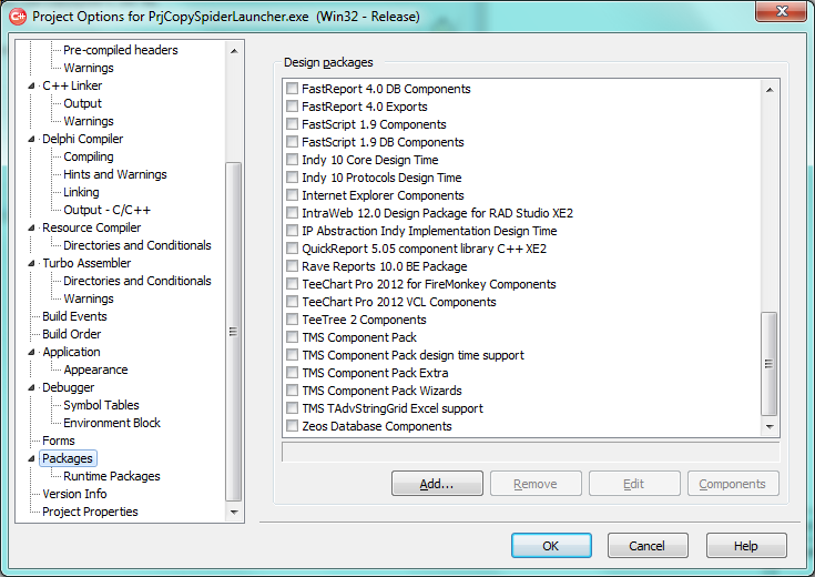

I've uninstalled TeeChart and reinstalled it again. I replied "Yes" as you said. Also, the C++ paths in the "32-bit Windows" platform are OK in my IDE. So, if I create a "VCL Forms Application - C++ Builder", in the Project Options the TeeChart Packages are unchecked:
If I try to select the "TeeChart Pro..." items, I get:

For future reference (Fig. 2).
For future reference (Fig. 1).

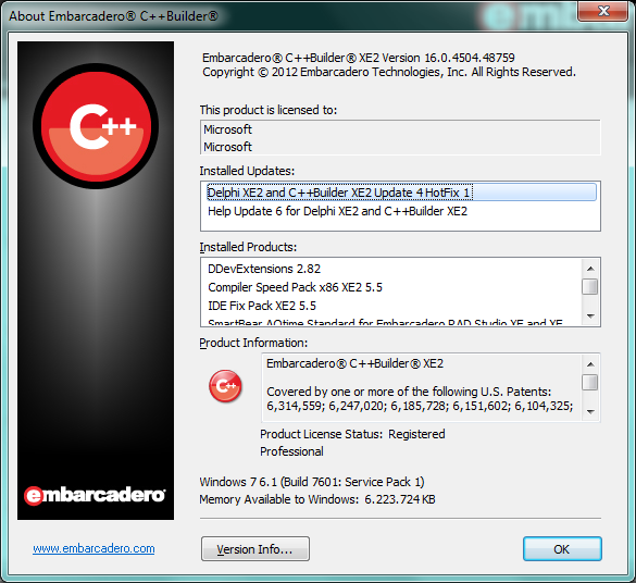

Maybe the IDE you are using isn't up-to-date?
Note TeeChart packages shipped with the binary installers are always built with the latest version of the IDEs they are built for.
In the case of RAD XE2 it should be Update 4 Hotfix.
http://cc.embarcadero.com/item/28882

Post by macicogna » Mon Apr 25, 2016 12:50 pm
I think it is updated, as you can see in the attached image.

C++Builder XE2 Update 4 Hotfix 1

Thanks to your previous comments. Problem Solved!
Actually, I've figured out that the error source was due to "Embarcadero LiveBindings Components VCL" package not checked in my projects.
