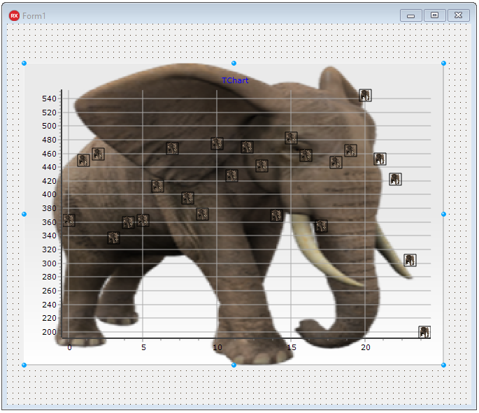

I'm getting an AV from TeeChart Editor n Design Mode when using PNG background image and a png series Image.
I' trying to move a single point series point wih a png image over a png background - transparency enabled.
First time adding the image works - no AV. When closing the Editor with OK and reopening the editor, the AV happens.
Simple project - blank chart, 1x PointSeries, 2x png

Post by Yeray » Wed Mar 02, 2016 10:24 am
I may be doing something wrong because it seems to work fine for me here:
Could you please arrange a simple example project we can load to reproduce the problem here?
