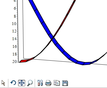

When move or rotate a chart using TeeCommander, the original 2D chart becomes a 3D chart by itself. How to keep a chart in 2D view when it been moved or rotated?

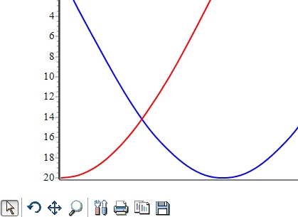

That's a limitation on the rotation feature. It requires the chart to be in 3D to take effect.
Some alternatives I see:
- Set the Chart3DPercent to 0:
Chart1.Chart3DPercent:=0;
- Change your TLineSeries for TFastLineSeries.

Using TeeCommander to move, rotate or zoom, the chart properties (such as series color) change.
Re: Keep the chart in 2D view when moving or rotating.
Post by Yeray » Thu Jan 28, 2016 9:26 am
sripe wrote:Using TeeCommander to move, rotate or zoom, the chart properties (such as series color) change.
If you are using the first approach - using a TLineSeries with Chart3DPercent=0 - I'd suggest you to also set the series' LinePen.Color to be the series' Color. Ie:
uses Series;
  Chart1.View3D:=false;
  Chart1.Legend.Visible:=false;
  with Chart1.AddSeries(TLineSeries) as TLineSeries do
    FillSampleValues;
    LinePen.Color:=Color;
The second approach - using a TFastLineSeries instead of a TLineSeries - may make more sense in this case.

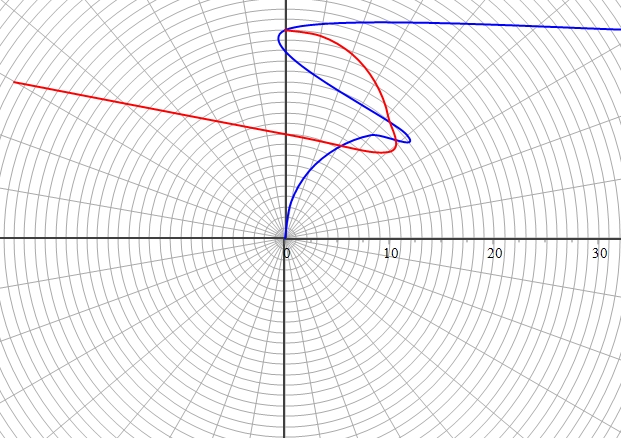

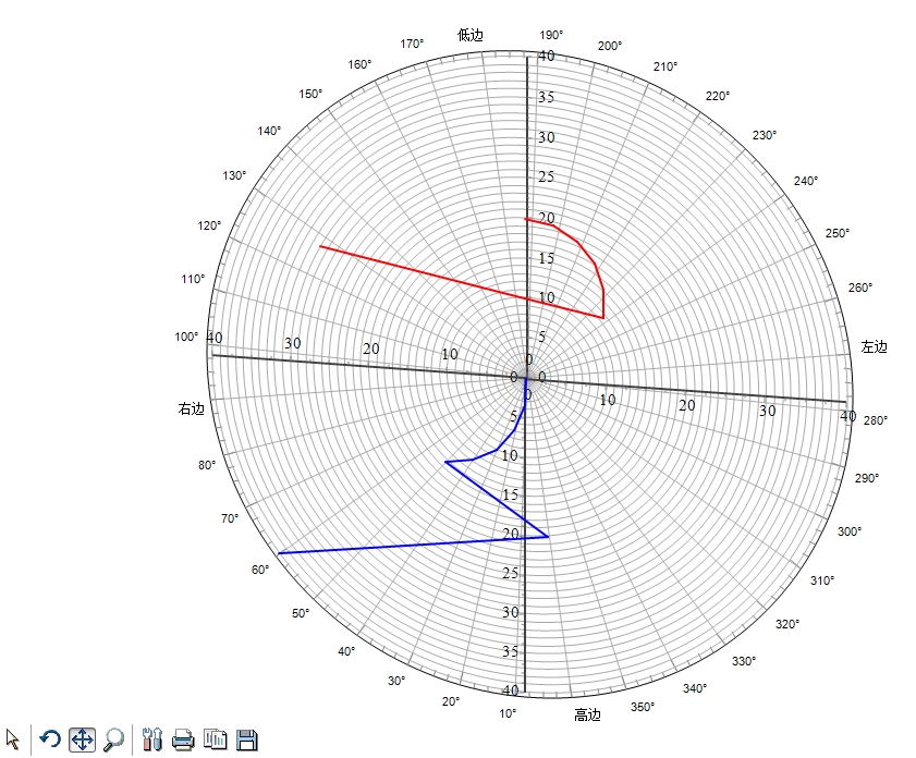

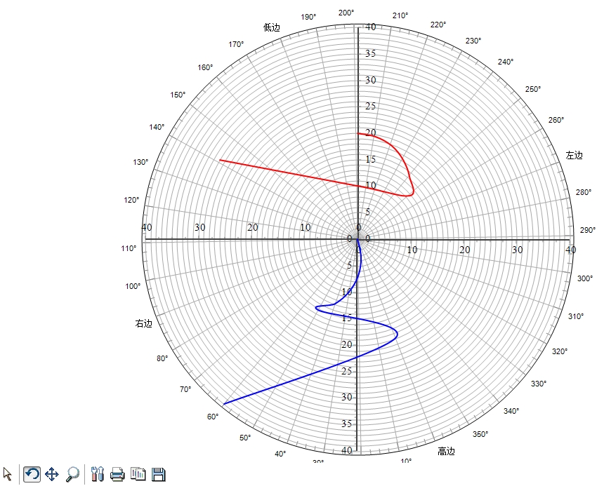

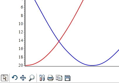

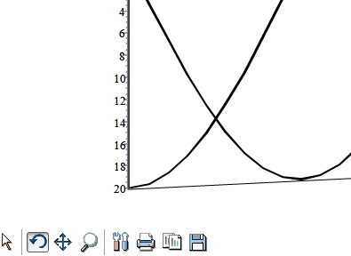

It works well with TLineSeries. But, using TeeCommander to move, rotate or zoom TPolarSeries, there are two problems:
1. When moving or zooming the chart, it inclines (tilts, leans) by itself. (see Fig1)
2. When rotating the chart, the selected series (there is a ChartListBox1 on the Form, and ChartListBox1.SelectedSeries is active) and the Chart rotate, but the other PolarSeries do not follow the rotating command. (see Fig2)

sripe wrote:1. When moving or zooming the chart, it inclines (tilts, leans) by itself. (see Fig1)
I see it moving/zooming deactivates the 3D, but other than that I can move/zoom the chart around without problems:

sripe wrote:2. When rotating the chart, the selected series (there is a ChartListBox1 on the Form, and ChartListBox1.SelectedSeries is active) and the Chart rotate, but the other PolarSeries do not follow the rotating command. (see Fig2)
http://bugs.teechart.net/show_bug.cgi?id=1423

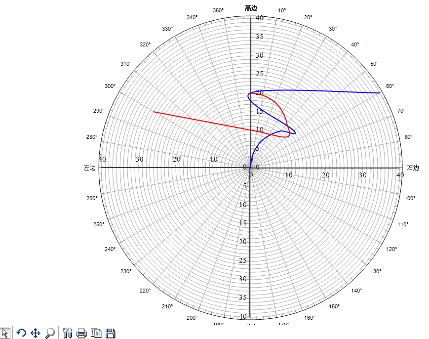

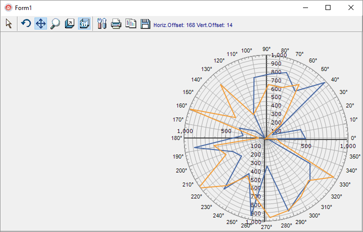

Using TPolarSeries, it seems that the four axes (RightAxis, LeftAxis, TopAxis and BottomAxis) do not intersect the same point at the center, although I use the following codes to make the chart show in 2D view.
with Chart1 do
View3D := false;
View3DWalls := false;
Chart3DPercent := 0;
Aspect.Rotation := 360;
Aspect.Elevation := 360;
Aspect.Perspective := 0;
Gradient.Visible := true;
How to make the four axes just right meet at the centre of a circle?
Post by Yeray » Tue Feb 16, 2016 11:34 am
sripe wrote:Using TPolarSeries, it seems that the four axes (RightAxis, LeftAxis, TopAxis and BottomAxis) do not intersect the same point at the center, although I use the following codes to make the chart show in 2D view.
I see. I've added it to the public tracker:
http://bugs.teechart.net/show_bug.cgi?id=1439
