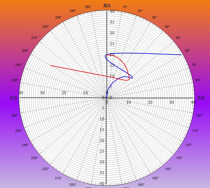

Re: How to fill the circle area with a picture for TPolarChart?
Post by Yeray » Thu Jan 28, 2016 9:21 am
This seems to work fine for me:
uses TeePolar;
var i: Integer;
  Chart1.View3D:=false;
  Chart1.Legend.Visible:=false;
  Chart1.Title.Visible:=false;
  Chart1.Gradient.StartColor:=RGB(240, 125, 20);
  Chart1.Gradient.MidColor:=RGB(150, 10, 240);
  Chart1.Gradient.EndColor:=RGB(200, 183, 225);
  for i:=0 to 1 do
    with Chart1.AddSeries(TPolarSeries) as TPolarSeries do
      FillSampleValues;
      Pointer.Visible:=false;
      Brush.Clear;
      Pen.Color:=Color;
      Pen.Width:=2;
      CircleBrush.Clear;
Don't hesitate to let us know if you still find problems with it.
