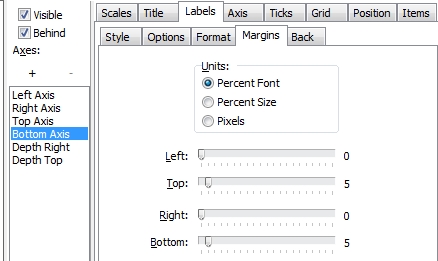

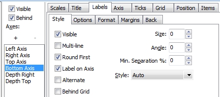

How to display Axis Labels at every Ticks?
Although I change the Label’s style and margins as far as possible, the Axis Labels do not display as crowded as expected (they are too sparse or few).

It seems that the labels arrangement on the BottomAxis not only relate to the BottomAxis component properties, but also relate to the CircleLabels properties. Sometimes, changing GetVertAxis.Increment or LabelsFont.Size do not get satisfied results. Generally, we expect to arrange the labels on the radial axes and the Radar/Polar circle, respectively. That is to say, the label’s properties on the radial axes and the Radar/Polar circle may be different. Do you have any good solutions to arrange the labels on the radial axes closely? Thanks a lot.
