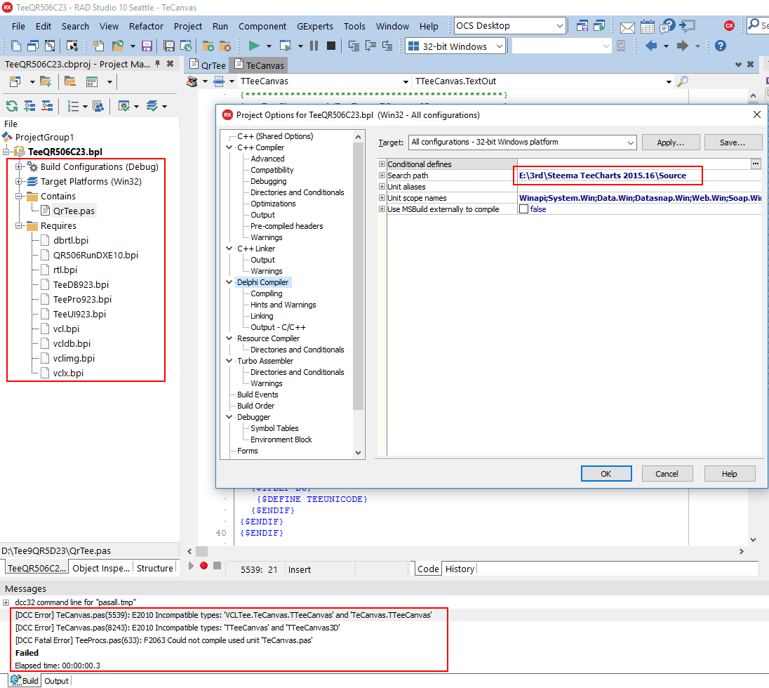

I´m having problems to build both the runtime- and design time packages with QR506/TeeCharts 2015.16 for C++ projects. The projects shipped with 2015.16 only support Delphi packages which don´t appear in the tool palette for C++ projects.
I set up a C++ Package project to create the C++ package files:
What do I have to do to create the TQRChart packages I can use in C++ projects?

The error sounds as if you missed to add VCLTee prefix into the "unit scope names".
Don't hesitate to let us know if you still find problems with it.

thank you for your message, but adding VCLTee to the unit scope names didn´t solve the problem.

We finally could make the packages to work on both Delphi and C++Builder projects.
Here the packages:
Tee9QR5D23.zip
(176.73 KiB) Downloaded 4797 times
