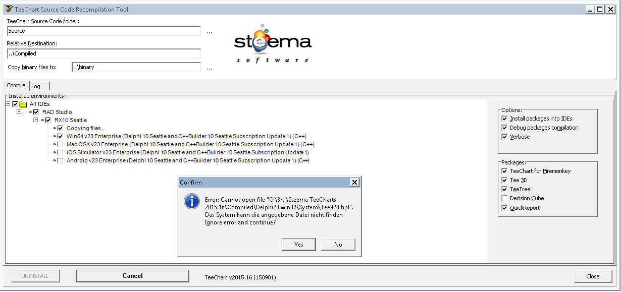

The TeeChartVCLSOURCE-2015.16.exe setup finished without errors, so I went on and ran TeeRecompile to install the TeeChart components into the IDE. TeeRecompile identified the Seattle installation and offered me various targets. I selected only two of them (Win32 v23 and Win64 v23), and TeeCompile presented this error message:
"Error: Cannot open file "c:\3rd\Steeam Teecharts 2015.16\Compiled\Delphi23.win32\System\Tee923.bpl. System cannot find the file specified. Ignore error and continue?"
Can you point me in the right direction?

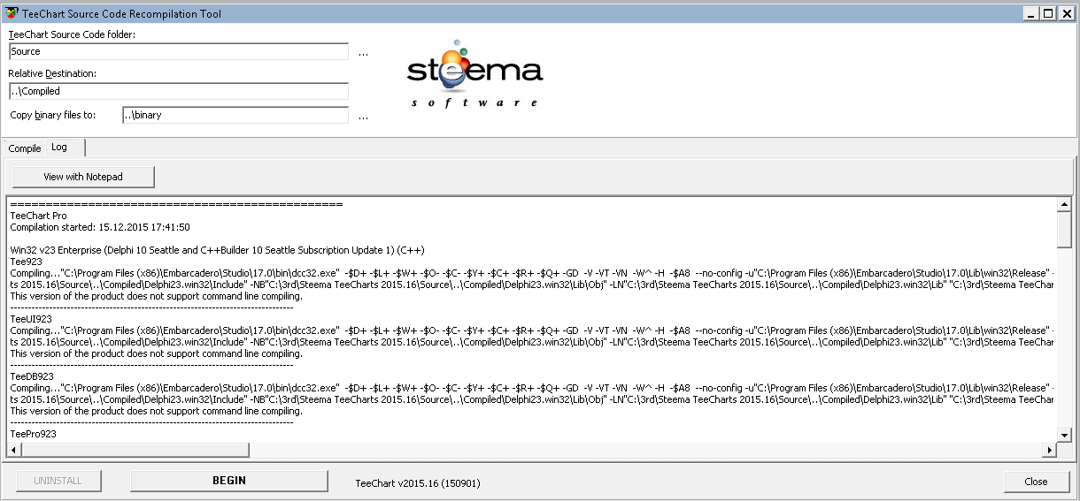

TeeRecompile log window
TeeRecompile main window

As it turns out it´s RAD Studio Seattle causing the problem. I am using the trial version which prohibts the use of the dcc32 command line compiler.
Invoking the dcc32 compiler yields the error messages shown in the log window.
