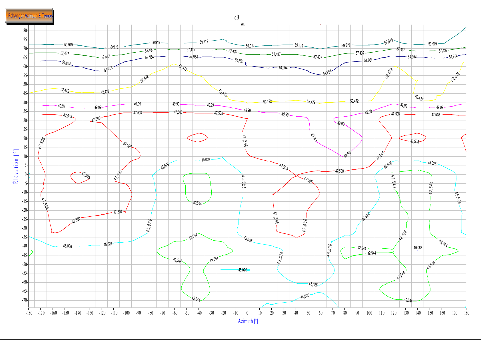

Is it possible to extract le numerical values of a contourseries for each of the selected levels?

jpm
Posts: 8
Joined: Tue Oct 06, 2015 12:00 am
Re: Tcontourseries
Post by jpm » Tue Dec 01, 2015 8:20 pm
What I would like to retrive are to points for each of the above colored lines at the different selected levels.
In the above example, I have lines at Level=59.919 . Level=57.437, ... some levels can be splitted in diffent level curve (here for example L=42.544 or 47.508 or...)
The goal is to save the equipotential/isothrm/equi-xxx positions for an external use.
best regards
Re: Tcontourseries
Post by Yeray » Wed Dec 02, 2015 12:06 pm
I understand you are looking for the arrays of Points into the Segments into the Levels. Here you have a simple example printing all the X and Y values for each Points array in each Segment in each Level:
