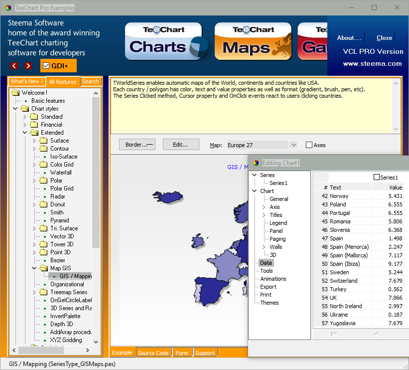

Markus wrote:or just have a look at the data. There are too many data rows in the map.
Looking at the data tab in the demo, the shapes don't look doubled there:

Post by Yeray » Mon Nov 02, 2015 11:17 am
This shapefile has 16 records; some records have a single shape but some of them have multiple shapes. That's why there are more rows in the "Data" grid than records in the shp file.
The "Value" field on the "Data" grid represents the ZValues array used to give a color to each shape.
