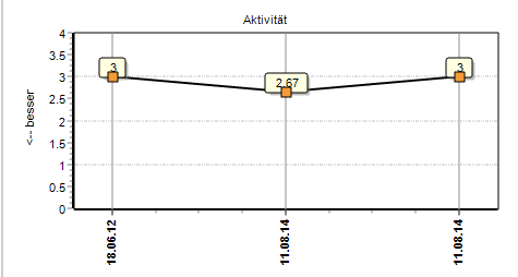

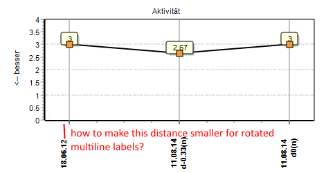

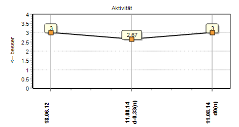

But now we have another Problem with custom labels: if the labels are rotated (90 degrees) and multiline then the position and size of the labels is wrong.
The position of the labels is to low and they are truncated because they are partly outside of the chart now. This can be corrected by setting Chart.BottomAxis.LabelsSize := some_value;
But I couldn't figure out how to adjust the distance between the labels and the axis (see screenshots). Any Idea how to correct that?

Re: Show/hide custom labels
Post by Yeray » Fri Nov 06, 2015 12:47 pm
This one sounds exactly like this, isn't it?
http://bugs.teechart.net/show_bug.cgi?id=528
