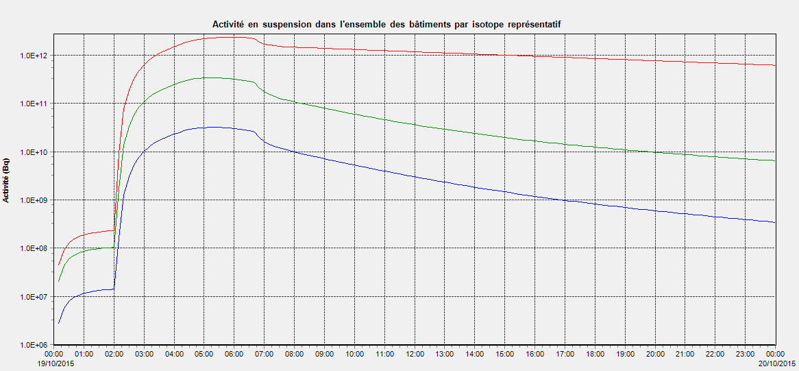

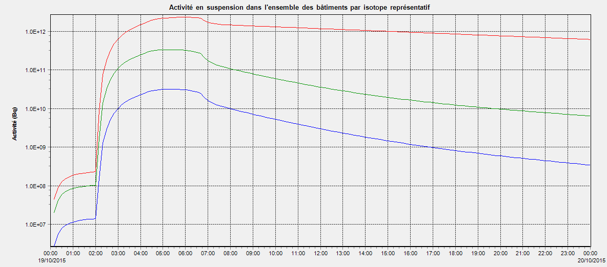

As it is illustrated on the attached screen capture, I need to have series with the vertical axis which has a first tick at its intersection with the horizontal axis.
In the attached example, I want to have 1E+9 displayed.
I had a careful look at the different options of the LeftAxis, but failed to come to something which is functional.
How can I force the Chart to display a first tick with label at the intersection of the x-axis and the vertical axis.

many thanks for the suggestion. This is indeed what I did in the end, but this was not enough. In addition, I had to fix the minimum value of the LeftAxis, such that the label at the intersection of the horizontal and the vertical axes is displayed. To do this, I simply:
- find the minimum of the series (s_min, s_min is always positive in my case),
- search for the value of n, such that 10^n+1 > s_min >= 10^n,
- fix LeftAxis.Minimum to 10^n
thanks
thanks
- LeftAxis.AutomaticMinimum := False + LeftAxis.Minimum := set to 10^n with 10^n+1 > s_min >= 10^n,

- LeftAxis.AutomaticMinimum := False + LeftAxis.Minimum := set to s_min
- CaptureBefore.PNG (36.66 KiB) Viewed 8436 times
