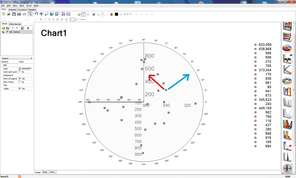

when using the DragPointTool with Polarseries which have inverted axes f.e. inverted bottom or left axis the point moves not in the same direction as the mouse cursor.
The blue arrow shows the movement of the mouse cursor, the red one the movement of the point to be dragged:

Post by Narcís » Wed Oct 14, 2015 9:43 am
Hello Heinz,
Thanks for reporting. I could reproduce the problem and added it (bug #1340) to the defect list to be fixed for future releases.
