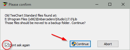

And I also got a dialog that asks me to accept to backup the TeeChart Standard/Lite that was shipped with the IDE:
I can open the IDE without problems after that installation.

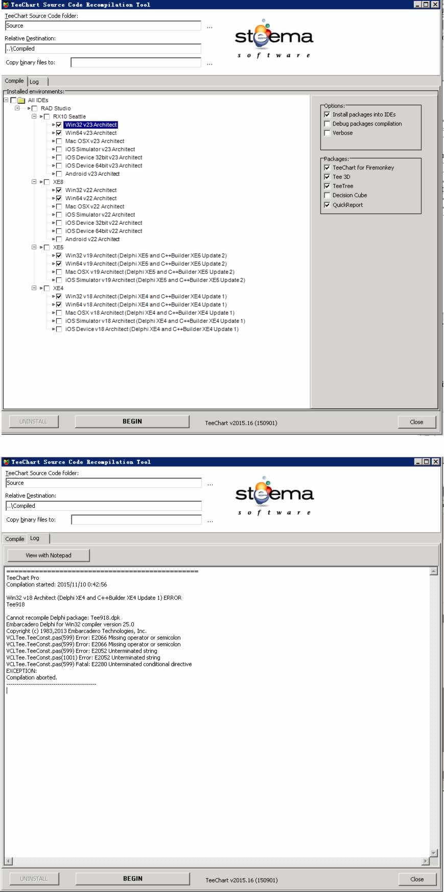

by 16576728
1. I reinstall it, cannot find the file "VCLTee.TeeConst.pas"
2. I found the file "VCLTee.TeeConst.pas" after run TeeRecompile.exe and get "Compilation aborted" message.
3. I checked file "VCLTee.TeeConst.pas",
Line 599 is : TeeMsg_Copyright :={$IFDEF LCL}'(C)'{$ELSE}'?{$ENDIF}+' 1995-2015 by Steema Software';
Line 1001 is: TeePolarDegreeSymbol :='?;
Why?
TeeChart Pro
Compilation started: 2015/11/10 21:06:00
Win32 v22 Architect
Tee922
Cannot recompile Delphi package: Tee922.dpk
Embarcadero Delphi for Win32 compiler version 29.0
Copyright (c) 1983,2015 Embarcadero Technologies, Inc.
VCLTee.TeeConst.pas(599) Error: E2066 Missing operator or semicolon
VCLTee.TeeConst.pas(599) Error: E2052 Unterminated string
VCLTee.TeeConst.pas(1001) Error: E2052 Unterminated string
VCLTee.TeeConst.pas(599) Fatal: E2280 Unterminated conditional directive
EXCEPTION:
Compilation aborted.

Note TeeRecompile takes the non-prefixed sources and creates the prefixed versions in the first stage; and puts them into VCL/FMX folders.
I see in your screenshot you are selecting several IDEs at the same time: RAD 10 Seattle, RAD XE8, etc. And it fails with that error when compiling for RAD XE8, so it has finished for RAD 10 Seattle. But I guess the file got corrupted between compiling for RAD 10 Seattle and for RAD XE8.
So I'd suggest you to do each compilation separately; and restore the original TeeConst file you backed up before each compilation; this is the file from the Sources folder, not the files with prefixes.
