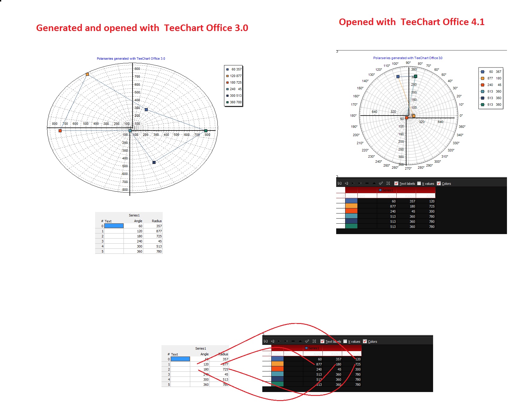

When loading charts generated with TeeChart 8 with PolarSeries in TeeChart 2015 the data points of the PolarSeries are not recognized correctly.
To reproduce the behaviour I generated one polarseries with TeeChart Office 3.0 and saved it as Polar 2007.tee
Polar 2007.zip
(712 Bytes) Downloaded 803 times
Then I opened it with TeeChart Office 4.1.
In the attached picture you can see the difference between opening the same chart with the older and newer version of TeeChart.
When looking at the data it is obvious that the angle and values of the points are not the same anymore.
PolarSeries 8 - 2015.jpg (359.07 KiB) Viewed 9385 times

Re: Older PolarSeries not compatible with TeeChart 2015
Post by Yeray » Thu Sep 24, 2015 8:57 am
Hello Heinz,
I've added a ticket in the public tracker:
http://bugs.teechart.net/show_bug.cgi?id=1318

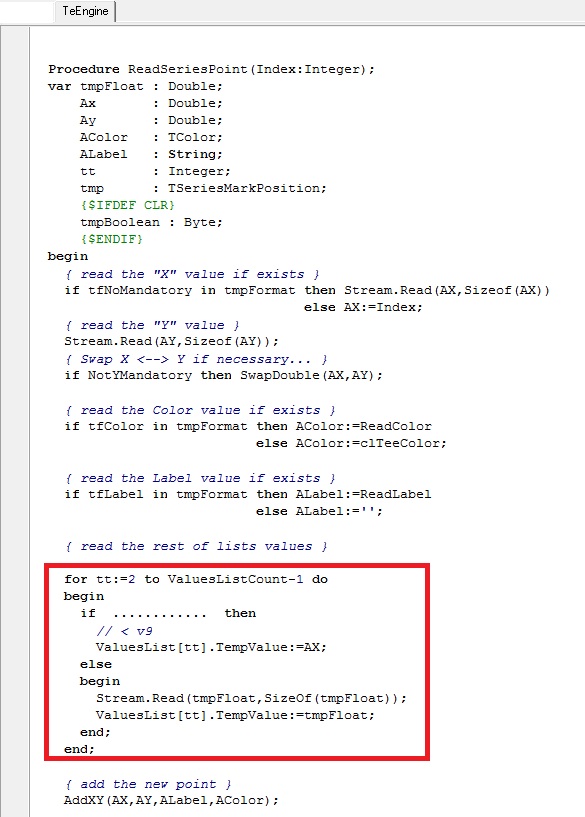

Post by SE_KG » Mon Sep 28, 2015 8:07 am
Hello Yeray,
the problem has it's origin in the TeEngine-Unit and the procedure ReadSeriesPoint. Modifying "read the rest of list values" as described in the attachement allows to read old and new polar data,
but I do not yet know how to differentiate reliable if the data is older than v9 or not.
Do you have a suggestion for the if-statement to work properly for all series?
Best regards
Heinz

SE_KG wrote:the problem has it's origin in the TeEngine-Unit and the procedure ReadSeriesPoint. Modifying "read the rest of list values" as described in the attachement allows to read old and new polar data,
I'm not sure that's the best way to fix this but your investigations may help us to find a solution for that ticket, so I'd like to thank you for sharing them.
