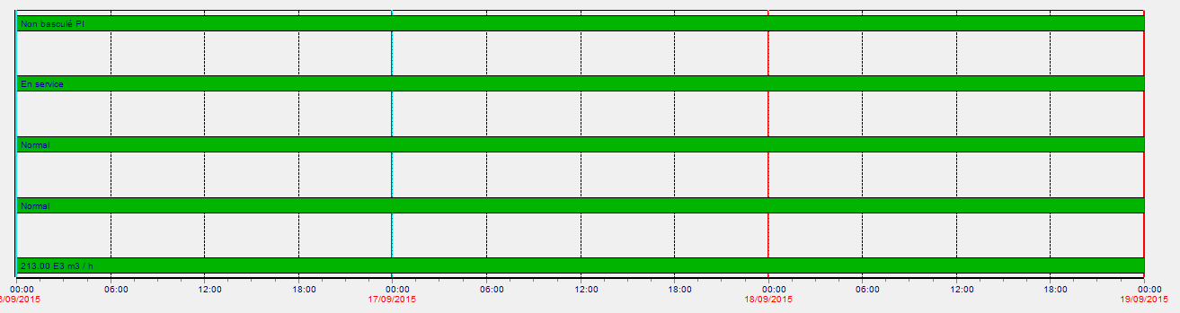

I do have a Chart, on which I draw a time series.
if the bottom axis grid overlap with the vertical red line drawn at each new day of the horizontal axis, I get a vertical cyan line.
Is there some approach I could use here to fix this issue, which is illustrated on the attached snapshot..

Hi, I will try to prepare some standalone example ASAP, in the meanwhile, maybe the attached screen snapshot could help to see the issue, I am trying to describe here.
Basically as you can see it, if the red vertical line overlaps the grid vertical line (dashed or not), you get some kind of blending of the two colors.
Is there a way to avoid that ? Is there some known issue about it?

I think the issue is that the lines drawn by the TColorLineTool are XOR'd with the background.
You can change this behaviour setting its DragRepaint property to true:
ColorLine1.DragRepaint:=true;

many thanks, your suggestion helped a lot. It works nicely now,
nabil
