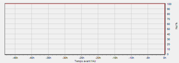

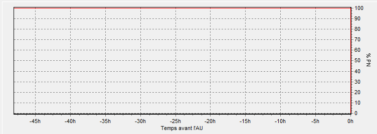

dear Support,
comparing TeeChart 2013 and TeeChart 6, I can see that with TeeChart 6, I get a better display quality than with TeeChart 2013 as it can be seen from the two attached files.
Do you have some hints on how I can proceed here to get a better chart display quality?
I could compare the two versions (Delphi XE2 and Delphi 7) for the displayed chart and see how to port these in the 2013 version, but would appreciate any information about how to handle this issue first, before digging in object property values.
As an additonal information, I could see that the trial 2013 TeeChart version chart quality is identical to what I get with TeeChart 6 pro version.
In advance, many thanks for any hint which could help to improve the chart quality.
canvas with TeeChart 2013 and application built with Delphi 7
canvas with TeeChart 6 and application built with Delphi 7 (Windows XP)

Post by Yeray » Wed Sep 09, 2015 3:03 pm
Hello Nabil,
I imagine by "better quality" you mean to disable the antialias.
Take a look at this:
http://www.teechart.net/support/viewtop ... 483#p66483

Post by cssesuc » Wed Sep 09, 2015 4:07 pm
Brillant! thanks it helped a lot.
