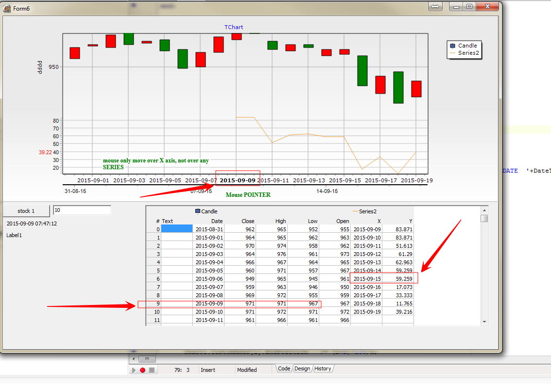

Good day,
Currently I am using the interpolation formula too axis my Y - values, but I found that my values does not match according to what the grid say.
My question is as follows :
I know what my x value is : example 2015-09-11 ( xval := Chart1.Axes.Bottom.CalcPosPoint(X);
Why cant I now loop through TCHartGrid for each column and each row and go and get each matching y value for each series matching my "Date"
Please see attached example.

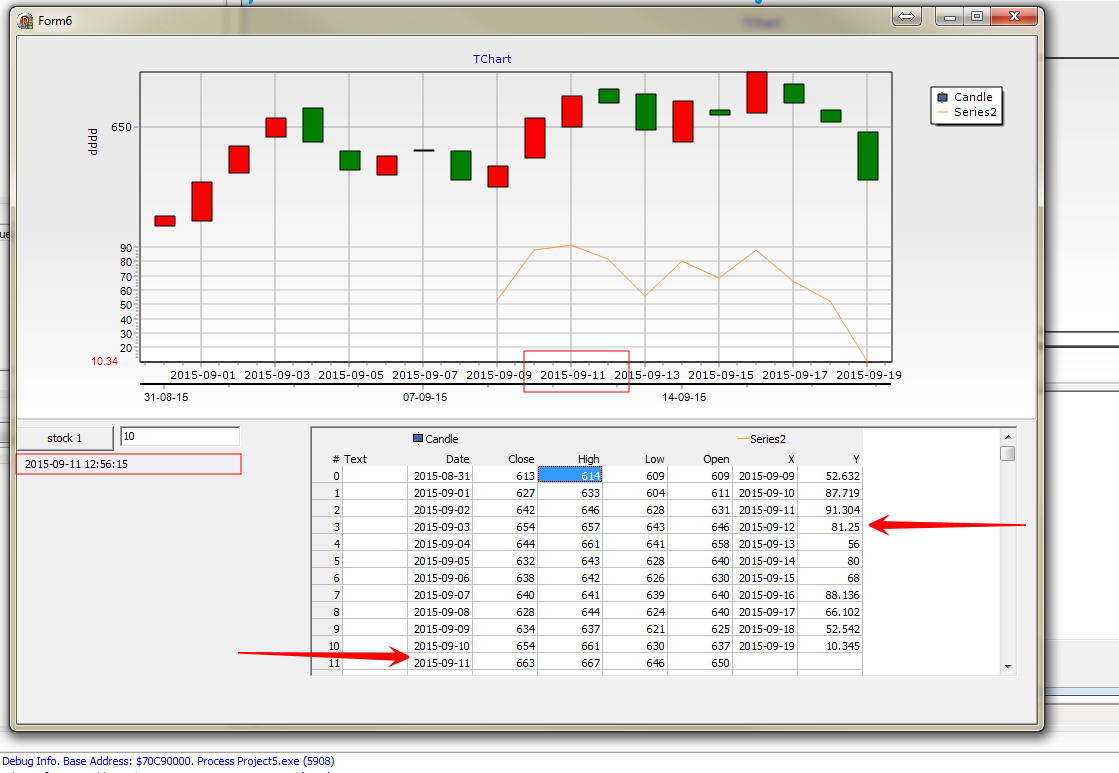

Sorry I think I lost you,
The only thing I asking if it is possible when my mouse is on the x axis, cant I get the exact value that is in the TchartGrid.
Example x = 2015/08/31
Give me the exact value of all Y series for the 2018/08/31; The answer in this case is 52.632 for Series 2

This is what I am trying to explain
procedure TForm6.Chart1MouseMove(Sender: TObject; Shift: TShiftState; X,
Y: Integer);
var Index,IndexLine : Integer;
xval , stock : Double;
Index := tmpMyCandle.Clicked(X, Y); // GET INDEX OF CLICK CANDLE
xval := Chart1.Axes.Bottom.CalcPosPoint(X); //INDEX OF X AXIS -> WE HAVE THE DATE NOW
MouseCloseAnnot.Active:=Index<>-1;
FloatToStr(tmpMyCandle.CloseValues[Index]); // WE HAVE THE CLOSE VALUE FOR THE DAY THIS IS PERFECT !!!!!!!!!!!!!!
///QUESTION why cant we with a line series do the similar as a a candle series, or dont I understand something not right

I please see sample code with explanation.
Here is another screen shot of what I am trying,
sample.zip
(11.59 KiB) Downloaded 942 times
Re: Easier way to axis Y value
Post by Yeray » Tue Sep 01, 2015 9:11 am
There are still some details I still don't understand. Ie, I'm not sure if you want the YValue corresponding to the mouse X position or corresponding to the label under the mouse.
Taking the code from the Interpolating Line series example I pointed out in the last post, I modified your example showing a few variations:
ClickedAxisSample.zip
(4.17 KiB) Downloaded 948 times

Good day,
Sorry for the late reply, thank you very much this is exactly what I was looking for.
