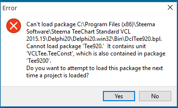

Seems I haven't quite got there. The install ran fine with the additional files, but I now get this error.
Re: Problem installing Teechart
Post by Yeray » Mon Aug 31, 2015 8:32 am
It seems that the TeeChart Lite version shipped with the IDE hasn't been correctly uninstalled from the list of packages the IDE loads at the start.
I'd suggest you to uninstall it manually from the list of packages and reopen the IDE.

Post by Colin » Mon Aug 31, 2015 11:03 pm
Turned out I had to reinstall Report Builder, but your comment put me on the right track.
