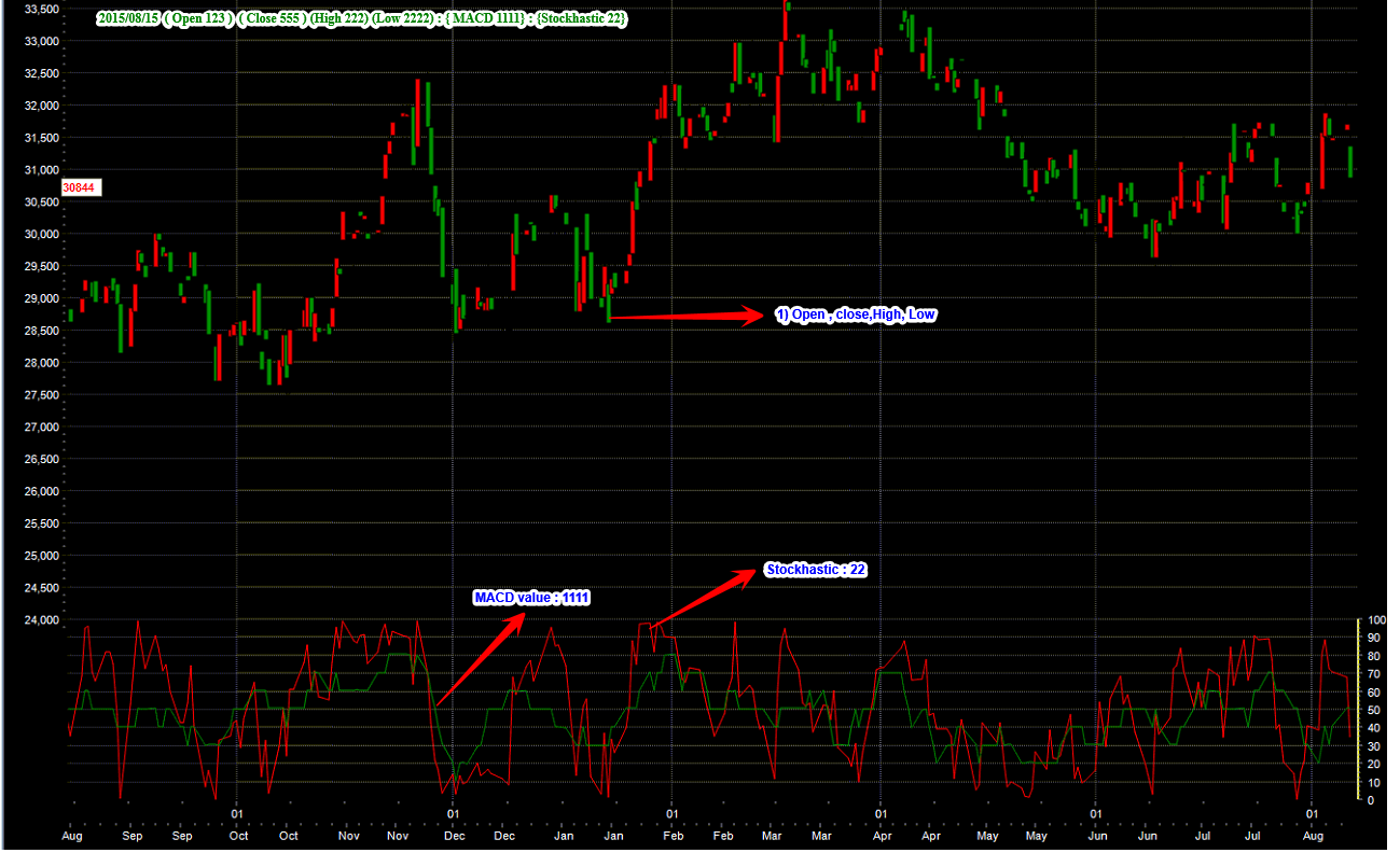

I am at a point were I am stuck and a bit confused with getting the correct x and y values for a specific point on the chart for functions or chart.
In the following example I have a bar chart with a stockhastic and macd function, I am trying to display all the current values at once on a label on the form, but with no luck do I get the correct values at once.
I have included a screen shot with my idea I am trying to accomplish.
Sample screen shot

I have created a sample application to try and explain what I am trying to accomplish. I am trying to display all the values of the functions and candlestick if I move my mouse over any area of the chart. At this stage the value only diplay if the mouse points to a specific function.

What you request is very similar to the interpolation example (All features\Welcome!\Chart Styles\Standard\Line (Strip)\Interpolating Line series) in the new features demo, available at TeeChart's program group, which I also implemented here. I also attach your project with the modifications applying the interpolating demo.
