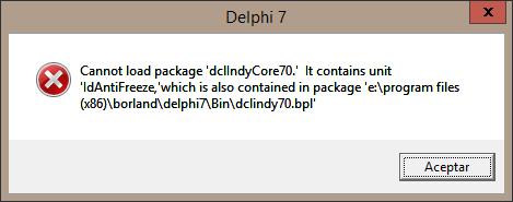

- I found an error when tried to install dclIndyCore70.dpk:

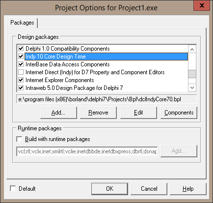

- I've unselected the Indy component that was shipped with Delphi 7: "Internet Direct (Indy) for D7 Property and Component Editors", dclIndy70.bpl.

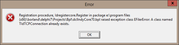

- I found another error when tried to install dclIndyCore70.dpk:

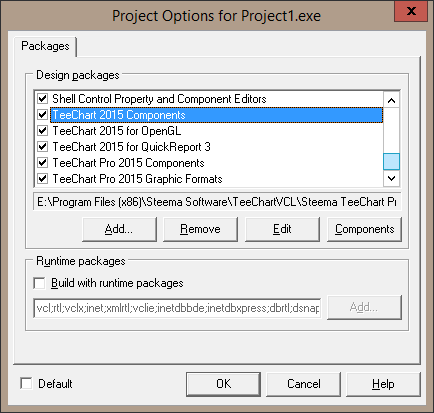

- I've unselected all the "TeeChart *" components. Now I could install dclIndyCore70.dpk. And after it I could reselect the "TeeChart *" components:
Is that what you are trying to achieve?
Is the procedure above working for you?
