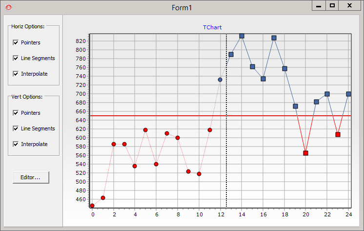

I've modified the example to also implement what I tried to explain in the last post. So now the example includes two ColorLines, an horizontal and a vertical. The horizontal line does the same than before: the points/line segments below the colorline are drawn in red.
The vertical line does what I understand you are trying to achieve: the points/line segments on the left of the colorline are drawn using a circle pointer and dashed line.
testInterpolation.zip
(3.69 KiB) Downloaded 773 times
It seems to work fine for me here, and I can move the mouse around the chart without missing any of the features:
