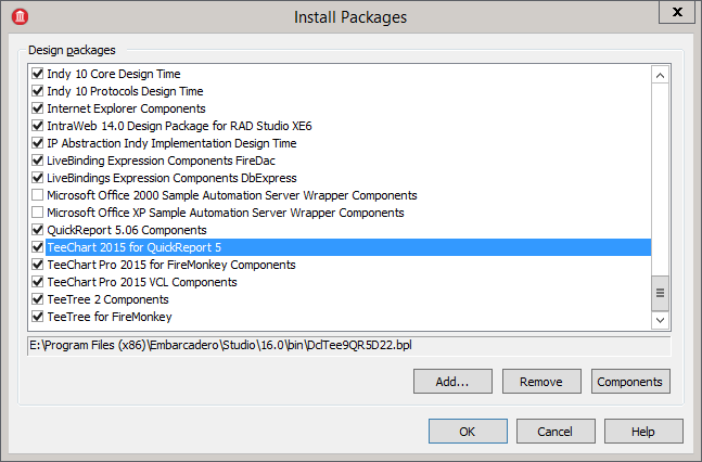

Re: Trying To Install VCL XE8 For QuickReports Pro
Hello Rick,
-The palette/toolbox.
The components in the palette can be organized in sections but they can be changed, so they can be wrong. Or in the case of TeeChart, since there are components shipped with the IDE, when the Pro version is installed they may rest in the place where they originally were. - The list of components is accessible through "Component\Install Packages..."
It shows what packages are being loaded into the IDE. This is the list you should check. I've re-checked compiled packages Sandra posted in that thread I mentioned and they seem to work fine for me with TeeChart Pro v2015.15 in XE8.
Note the difference between:Rick Hillier wrote:The Tool Palette tab still reads TeeChart Lite, but right clicking the teechart when I drop it on a form shows the pro version. There are other controls (I assume related to TeeChart) on that tab too, but I have no way of knowing what version they are.

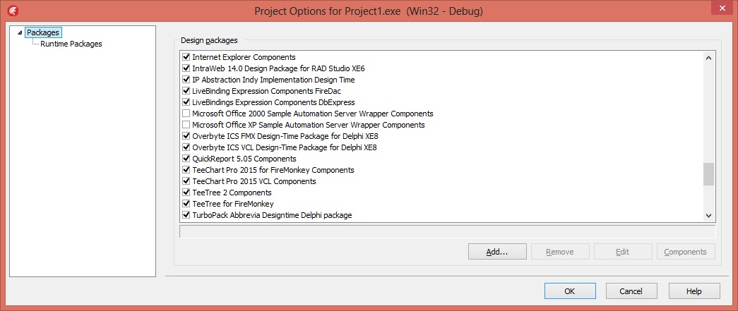

I did check that... I haven't done a whole lot with the IDE yet, as I don't have everything installed yet. TeeChart is one of the more important ones I use, so it was one of the first. I have to assume that your installer would have removed the standard version. I have attached a jpeg of what's in mine...
- Components.jpg (107.31 KiB) Viewed 21916 times
I see you are using QuickReport 5.05. Note the latest version of QuickReport is v5.06.
That could be a difference making the packages we compiled here not to work fine in your environment.
If you don't want to upgrade to v5.06 we'd need to recompile the TQRChart packages for that environment, following the instructions here.
However, the error indicated tee*0 (the TeeChart Lite/Std package shipped with the IDE) was still being loaded.
Have you tried to create a new simple example project with just a TChart on the form? If it builds fine, try to output the build version that is being used. Ie:
