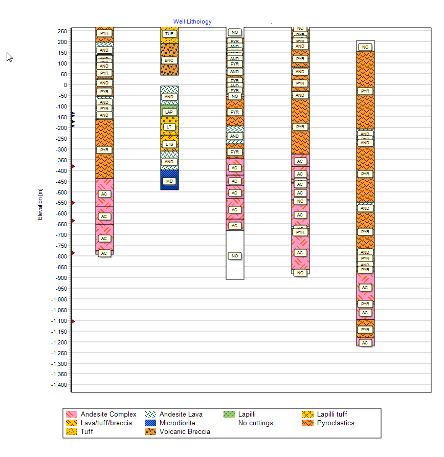

I use stacked bar charts to represent well lithology. Rather than starting at zero, the vertical origin of the charts are offset by an amount corresponding to the elevation of the wellhead. However, when I plot the charts they do not auto-scale but run off the top of the chart, as shown. Any idea why this might be happening? The elevations of the wells are 282, 282, 292, 292 and 206 m respectively.

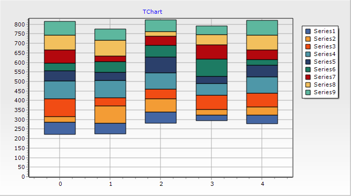

You can set a different Origin for each TBarSeries but I understand you need to set an offset for each value.
Then, you'll need to use TBar3DSeries instead of TBarSeries. Just note that with them you'll have to play with the offsets to manually synchronize the offset of each value matching predecessor series values+offset. Ie:
var i, j, n: Integer;
    tmp: Double;
  Chart1.View3D:=false;
  for i:=0 to 8 do
    with Chart1.AddSeries(TBar3DSeries) as TBar3DSeries do
      for j:=0 to 4 do
        if (i=0) then
          tmp:=200+random*100
          tmp:=(Chart1[0] as TBar3DSeries).OffsetValues[j];
        for n:=0 to Chart1.SeriesCount-2 do
          tmp:=tmp+Chart1[n].YValue[j];
        AddBar(j, 25+random*75, tmp);
      MultiBar:=mbStacked;
      Marks.Visible:=false;

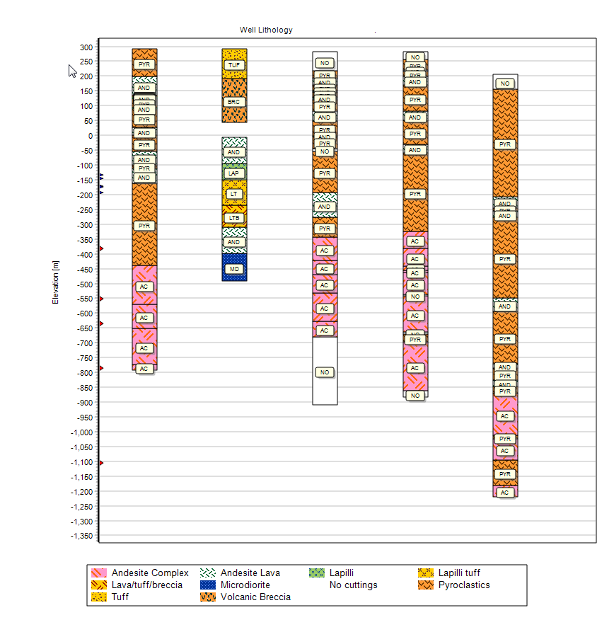

Hello Yeray. Thanks for your reply but I think we may be talking at cross-purposes here, probably because I did not explain well enough. We have developed a UnitBarSeries unit with which I am able to offset the bar charts correctly simply by setting a YPosition variable for each chart, which corresponds to the elevation of each well. See attachment with the charts dragged down to show the tops of each bar chart. However, when I unzoom, the charts go off the top of the graph, by a small amount as shown in the previous post. How can I control automatic scaling to show the whole graph?
