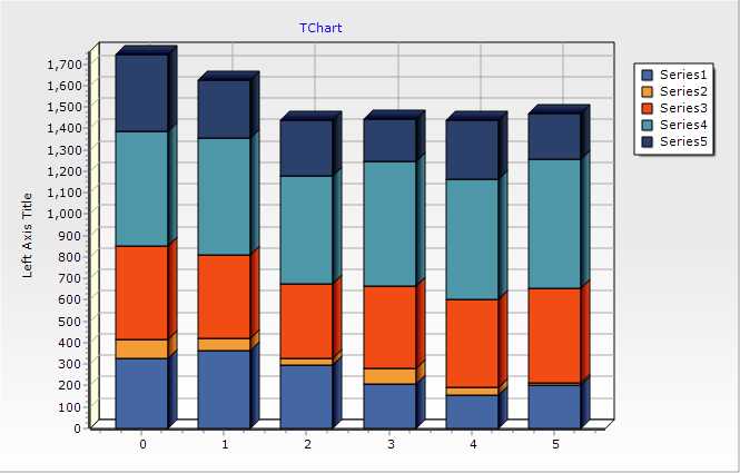

This seems to work fine for me here:
var i: Integer;
  Chart1.Axes.Left.Title.Caption:='Left Axis Title';
  for i:=0 to 4 do
      FillSampleValues;
      MultiBar:=mbStacked;
      Marks.Visible:=false;
Are you using the latest TeeChart version, v2015.15?
Could you please modify the code above or to arrange a simple example project we can run as-is to reproduce the problem here?

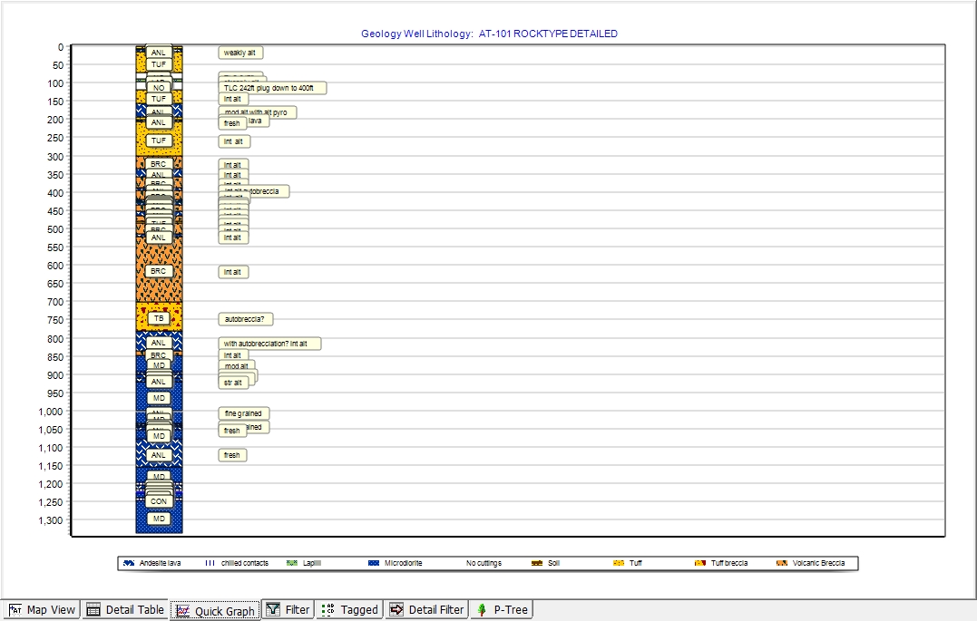

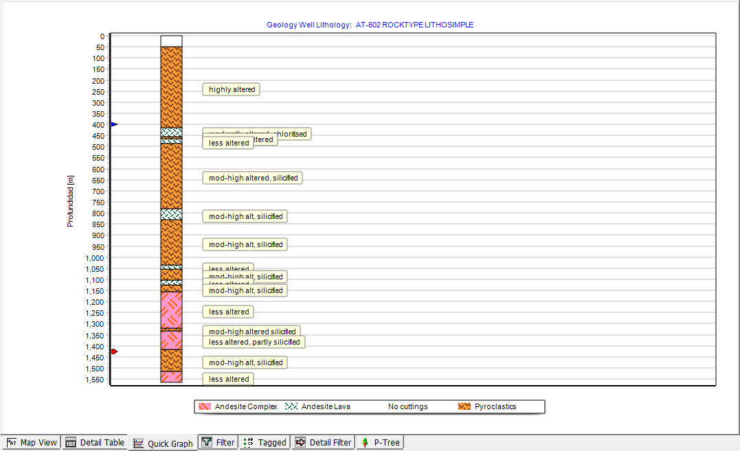

Thanks for your reply to my last post and sorry for the delayed reply. I have since determined that the graph offset is caused by assigning a title to the left axis, using the following command:
YLabelDisplay := ldField;
ldField is the current display name of the axis. I use the same command to assign a title to the left axis of an ordinary line graph and this does not cause the graph to be offset, so I would be grateful if you could suggest a workaround for this problem.
I have attached two graphs showing the offset when a title axis is assigned.
Thanks and regards
Errol
