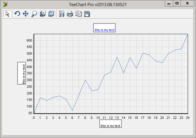

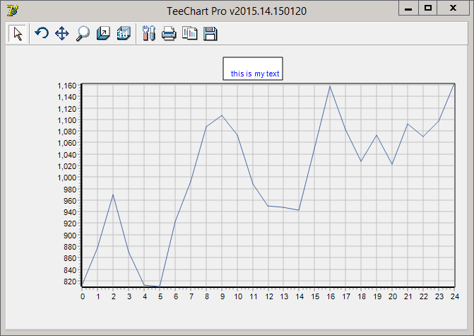

I've made a simple test application: This is how it looks with v2013.08: This is how it looks with v2015.14: Note the #13 is the Carriage Return character. I'm not sure to understand how would you expect a string starting with a carriage return to be drawn.

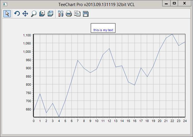

I downloaded the sample you kindly posted, but unfortunately, it does not work. I don't even see the text label:
myText:=#13 + 'this is my text';
I am using the official 2013 version, namely: 2013.09.131119 and I am running it with Embarcadero® Delphi® XE2 Version 16.0.4429.46931

I get this with XE2 and TeeChart v2013.09:cssesuc wrote:I downloaded the sample you kindly posted, but unfortunately, it does not work. I don't even see the text label:

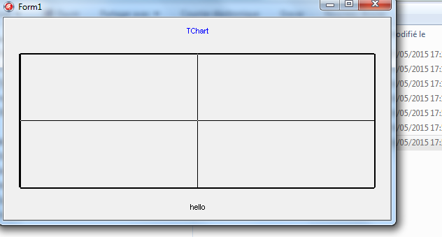

Find attached a basic project, for which you can see the issue
As I said, if I implement:
chart1.BottomAxis.Title.Text:= 'hello' + TeeLineSeparator + 'this is my axis title';
it will show ONLY 'hello'
Playing on the margin does not help.
I attach to this post the output canvas as well as the entire project, such that it can be checked.

can one expert please tell me how to solve this issue. I implemented the solution suggested on one other post, but this is not really elegant.

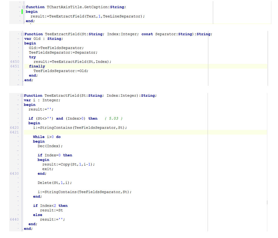

I believe there is a bug in the approach used here which explains why if a title contains a #13, any string after is simply ignored. IMHO the way the GetCaption is implementing the call to the TeeExtractField is buggy
thanks.

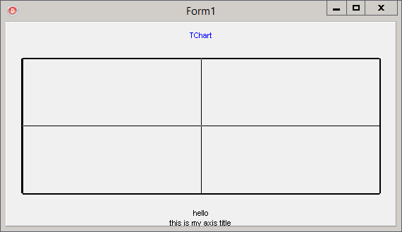

I see the project you attached reproduces the problem in v2013.09. However, it seems to work fine in the actual version, v2015.15: So the easier way around is using the latest version.cssesuc wrote:can one expert please tell me how to solve this issue. I implemented the solution suggested on one other post, but this is not really elegant.
