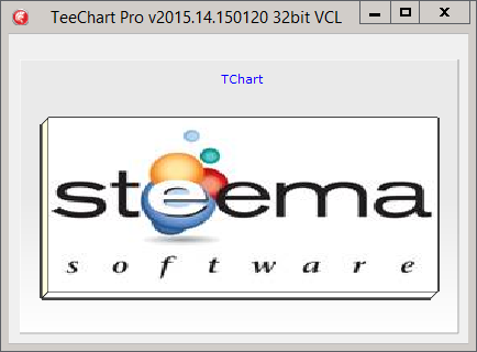

I'm trying to reproduce the problem with TeeChart Pro v2015.14 in a new "VCL Forms Application - Delphi" in RAD Studio XE6. I just created the project, dropped a TChart component into the main form and added the following code:
uses VCLTee.TeeTools;
  with Chart1.Tools.Add(TChartImageTool) as TChartImageTool do
    Picture.LoadFromFile('E:\tmp\steema_logo.jpg');
And it seems to work fine for me here:
