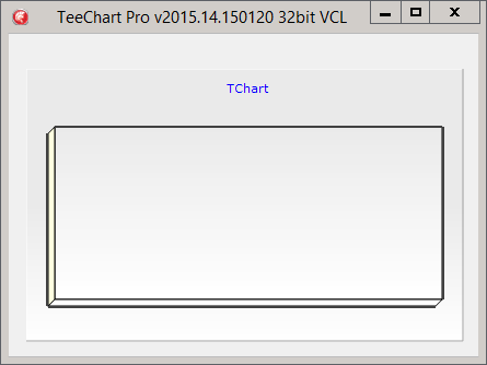

Are you using the latest TeeChart Pro v2015.14?
You can check it adding the TeeConst unit to the uses clause and showing the TeeMsg_Version constant somewhere.
I drop TChart into an empty form on a new VCL application in Delphi XE7, I add the following code and I can move the mouse around with no error here.
May I be missing anything else to reproduce the problem?
uses TeeConst;
  Chart1.Legend.LegendStyle:=lsValues;
  Chart1.Hover.Visible:=True;
  Caption:=TeeMsg_Version;

Post by Alexandre » Wed Mar 11, 2015 7:02 pm
I was using the TeeChart Pro 2014. I updated to latest version (2015) and this problem is solved.
