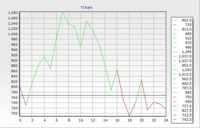

I've made a simple example that seems to works fine for me here.
I'm using random values, so I've calculated a threshold between the minimum and maximum values in the series (t) and I'm using it instead of your zero.
I'm also using a TColorLineTool to highlight that threshold. This the code I used:
uses Series, TeeTools;
var i: Integer;
    t: Double;
  Chart1.View3D:=false;
    FillSampleValues;
    t:=YValues.MinValue+(YValues.MaxValue-YValues.MinValue)/5;
    for i:=0 to Count-1 do
      if YValue[i] >= t then
        ValueColor[i]:=clLime
        ValueColor[i]:=clRed;
  with Chart1.Tools.Add(TColorLineTool) as TColorLineTool do
    Axis:=Chart1.Axes.Left;
    Value:=t;
And this is what I get:
Note that TeeChart draws the line segments in the color defined by the ValueColor on the index of the point in the right of the segment.
Also note the TLineSeries has to be set to use dsSegments DrawStyle; dsAll and dsCurve use the series Color property to draw all the series at once. dsSegments is the default DrawStyle so I didn't set it in the example above but I found it was worth mentioning it:
(Chart1[0] as TLineSeries).DrawStyle:=dsSegments;
