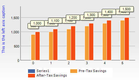

In the very simple attached demo there are a couple problems:
1) Marks overlap
2) Title on left axis, which includes a #13, is pushed off the side of the chart.
I don't believe was a problem in an earlier version. (I remember working the top margin so that the marks would not overlap).
If a patch is available, I would certainly appreciate it as I cannot release a build with this problem.

This is what I see when running your project here with the latest version:

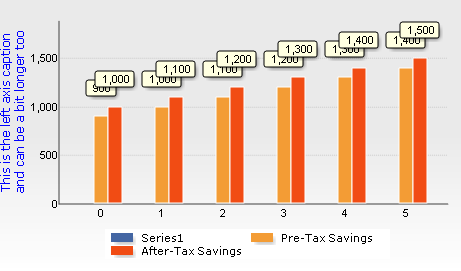

And this is how it looks if I run it with TeeChart v8, activating GDIPlus to better compare:

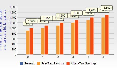

TestAlways wrote:2) Title on left axis, which includes a #13, is pushed off the side of the chart.
I see this was broken between v2013.08 and v2013.09:

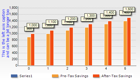

I see this has been partially fixed in this last v2015.14 (see the first image in this post) but it seems the margin is still not perfectly calculated.
I've added it to the public tracking system:
http://bugs.teechart.net/show_bug.cgi?id=1124
