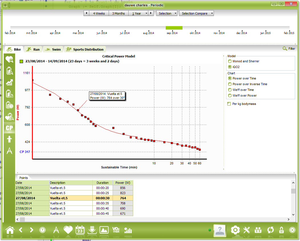

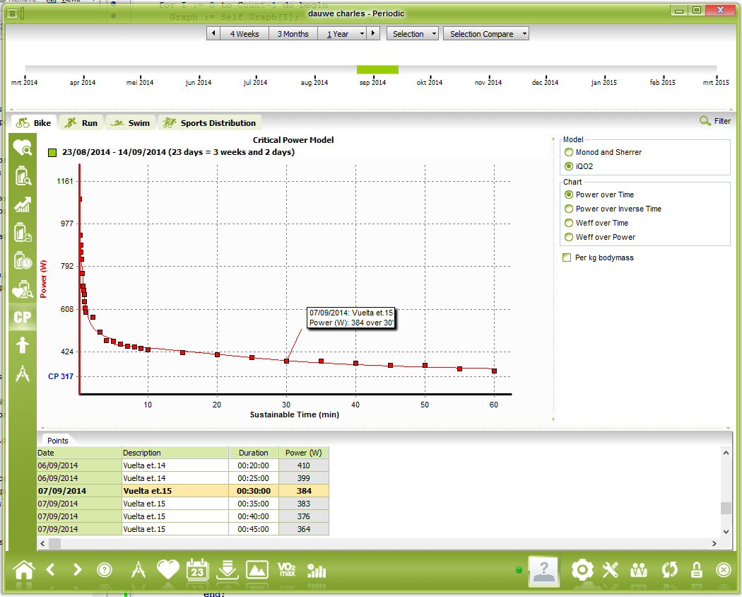

I have attached two screenshots
1st is the graph in non-logarithmic mode where the x-axis is divided into 10' increments
2nd is logarithmic mode, also divided in 10' increments
I set the bottom axis min/max values myself = 5/60 .. 60, or from 5" to 60'
The problem I have is that changing the LogarithmicBase property does not change anything how the bottom axis is scaled. Set it to 2 or 100, no difference.
I would like to scale it so the first 10 minutes is less spread out.

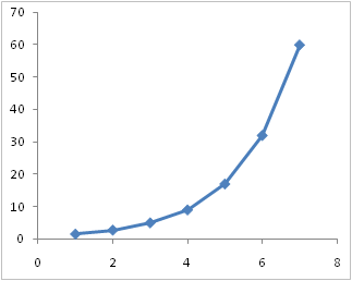

Take a look at this article where Jon Peltier explains how the log scale works in Excel and what to expect when changing the base (you can jump directly to the Excel 2007 part).
The data:
1, 1.5
2, 2.75
3, 5
4, 9
5, 17
6, 32
7, 60
The post entry starts with this:
Here’s the data in a default XY chart.

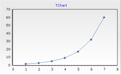

And here it is what I get if I load the data above in a TLineSeries with the default axes (I just change the min and max and some minor setting for aesthetics):
uses Series;
  Chart1.View3D:=false;
  Chart1.Legend.Visible:=false;
  with Chart1.AddSeries(TLineSeries) as TLineSeries do
    Pointer.Visible:=true;
    Pointer.Pen.Visible:=false;
    Pointer.Style:=psDiamond;
    AddXY(1, 1.5);
    AddXY(2, 2.75);
    AddXY(3, 5);
    AddXY(4, 9);
    AddXY(5, 17);
    AddXY(6, 32);
    AddXY(7, 60);
  Chart1.Axes.Bottom.Grid.Visible:=false;
  Chart1.Axes.Bottom.SetMinMax(0, 8);
  Chart1.Axes.Left.Grid.Visible:=false;
  Chart1.Axes.Left.SetMinMax(0, 70);

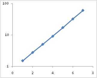

Here’s the data with the default base-10 log axis scale.

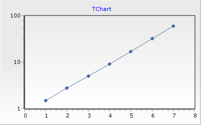

And this is what I get if I set the left axis to be logarithmic
uses Series;
    AddXY(1, 1.5);
    AddXY(2, 2.75);
    AddXY(3, 5);
    AddXY(4, 9);
    AddXY(5, 17);
    AddXY(6, 32);
    AddXY(7, 60);
  Chart1.Axes.Left.Logarithmic:=true;
  Chart1.Axes.Left.SetMinMax(0, 100);

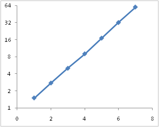

Here is the chart with a base 2 log axis scale.

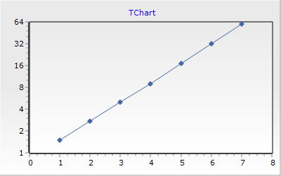

And this is what I get if I change to log base 2:
uses Series;
    AddXY(1, 1.5);
    AddXY(2, 2.75);
    AddXY(3, 5);
    AddXY(4, 9);
    AddXY(5, 17);
    AddXY(6, 32);
    AddXY(7, 60);
  Chart1.Axes.Left.LogarithmicBase:=2;
  Chart1.Axes.Left.SetMinMax(1, 64);
