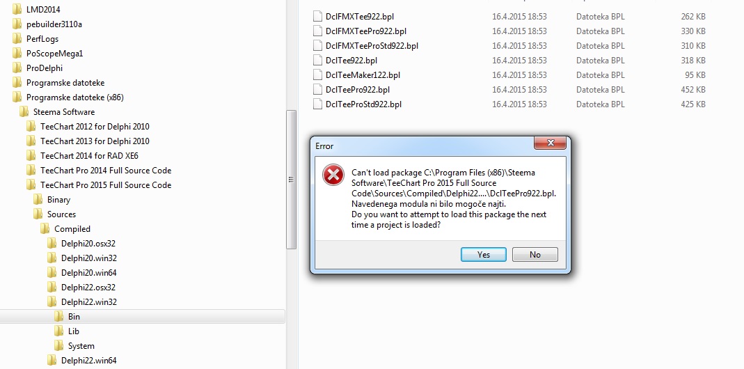

I have TeeChart 2015 with sources and Delphi XE8. For the first time ever I am experiencing problems with TeeChart component installation. I removed previously installed version (2014)and deleted bpls from Windows\System32 folder but I am receiving errors when starting Delphi XE8. It says it cannot find modules. I attached a screenshoot so you can see what is my folder structure.
I just run TeeRecompile and check Delphi XE8. Recompilation goes fine (except GDIAPI hpp warning) but when I start delphi I am getting all those errors. Even if I try to install packages manually it doesn't work.
BTW: Installation of TeeChart 2014 into DelphiXE6 works fine.

Re: TeeChart 2015.14.150120 VCL/FMX release available
Hello Aljosa,
TeeChart v2015.14 was published on January this year. RAD XE8 has been published this month so TeeChart v2015.14 didn't support XE8.
We are working on a release supporting XE8 and we hope we can publish it asap as you can read here.
My bad. I didn't pay attention to it. Thanks.
