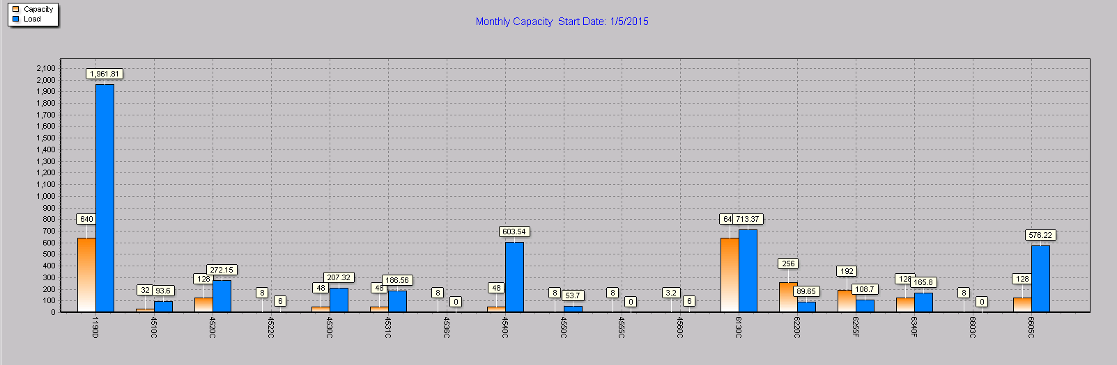

In the previous version of TeeChart (2012) the code ProfileCapacityBar.AddBar(y, XName, clTeeColor); labeled the X axis with the value in XName and when labels were displayed for the bars, the labels displayed the bar value as in the second example.

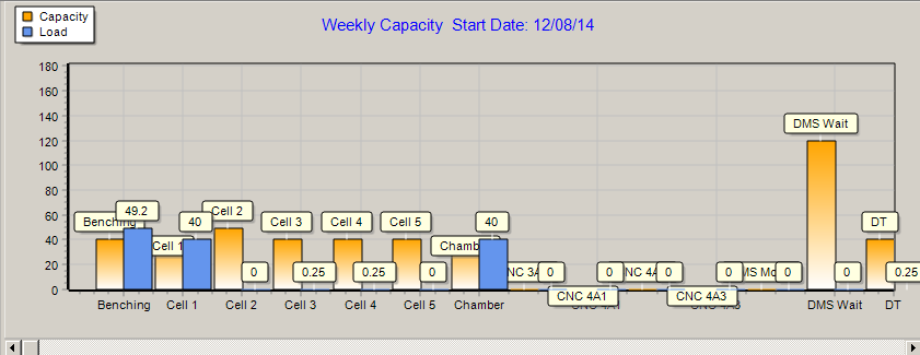

Using TeeChart 2014 the code ProfileCapacityBar.AddBar(y, XName, clTeeColor); or ProfileCapacityBar.Add(y, XName, clTeeColor); still displays the XName on the x axis, but when bar labals are displayed, the labels show the x axis name (first example).
How do I get the Add to function the same way as 2012?
