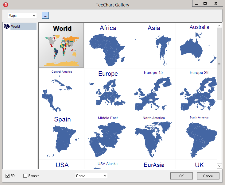

Post by Yeray » Mon Jul 13, 2015 11:00 am
Using the alternate gallery in TeeChart v2015.15 for XE7 I find the World series under the "Maps" section:
