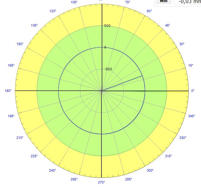

on the attached jpg it can be seen that the chart contains a line from the center of the circle at about 20°. This line is the first out of about 800 segments.
Before anything is drawn, I set the axis with the following lines, mb is 500.
SMEChart.LeftAxis.Automatic := false;
SMEChart.LeftAxis.SetMinMax(-mb, mb);
SMEChart.BottomAxis.Automatic := false;
SMEChart.BottomAxis.SetMinMax(-mb, mb);
The other attachment lists the values, I exported it using ChartEditor.
All radius values are close to zero, so where does the line from -500 to zero come from ?

Hello Gerhard,
After looking at your data file I see no explanation for that. Could you please attach a simple example project we can run "as-is" to reproduce the problem here?

Re: Polarseries draws unwanted line
Hi Gerhard,
Thanks for the information.
I could narrow the problem down to the code snippet below and it looks like a defect to me, which I have added to bugzilla (ID1096). Please feel free to sign up at bugzilla and add yourself to the CC List to receive status updates on the issue.
