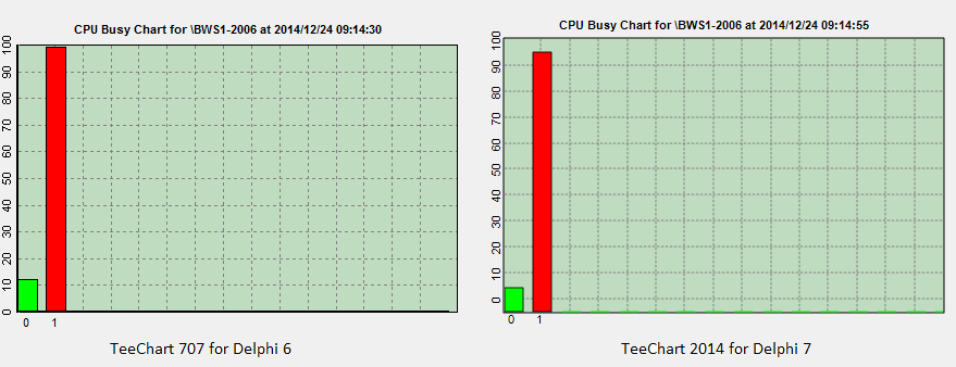

I am converting a program from WinXP/Delphi6/TeeChart v707 to Win7/Delphi7/TeeChart v2014.
The above attachment shows the different results.
Both charts have the same values (green is 12 and red is 99)
The TeeChart 707 for Delphi 6 correctly shows the Y value 0 at the base of the chart and the green value is at 12 red at 99
The TeeChart 2014 for Delphi 7 INCORRECTLY shows the Y value 0 up at approximately value 5 and the Green value seems to be about 5.
I cannot seem to find the chart setting to change the Y Axis to set 0 at the bottom of the chart and have the chart appear like the older version.
Any help would be appreciated

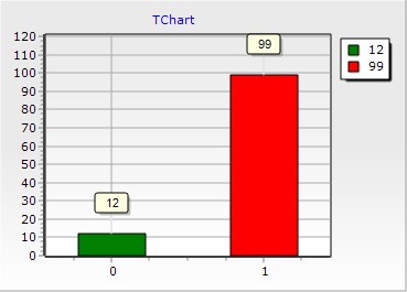

Using this code with v2014:
uses Series;
  Chart1.View3D:=False;
  Chart1.AddSeries(TBarSeries.Create(Self));
  Chart1[0].Add(12, '', clGreen);
  Chart1[0].Add(99, '', clRed);
I get this chart:
which is correct, just as your v7 chart. Does this code work fine at your end? Can you please attach a simple example project we can run "as-is" to reproduce the problem here?

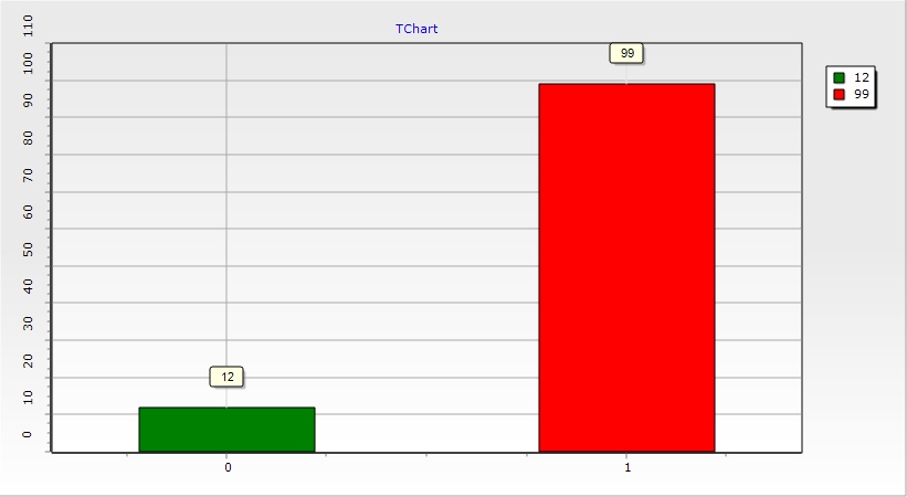

Thanks for the information. However, code below works fine for me here.
uses Series;
  Chart1.View3D := False;
  Chart1.Axes.Left.LabelsAngle := 90;
As you can see in this image:
Does this work fine for you? Can you please attach a simple example project we can run "as-is" to reproduce the problem here?
