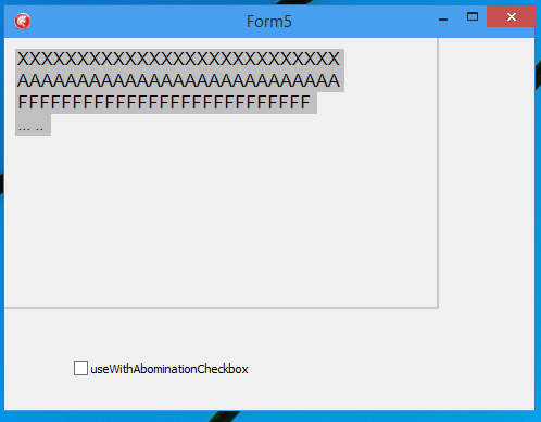

I have a feeling that this is going to be another prime example of why the with-statement in Pascal is a terrible abomination.
I refactored your code a bit. Please have a look at the produced output.
The code:
procedure printText(
	const	onCanvas:	TTeeCanvas;
	const   atPosition:	TPoint;
	const	text: 		String
var
	backgroundRect: TRect;
	Assert( Assigned(onCanvas) );
	onCanvas.Brush.Color := clSilver;
	backgroundRect := TRect.Create(
		atPosition.X,
		atPosition.Y,
		atPosition.X + onCanvas.TextWidth(text),
		atPosition.Y + onCanvas.TextHeight(text)
	onCanvas.FillRect(backgroundRect);
	onCanvas.TextOut(atPosition.X, atPosition.Y, text);

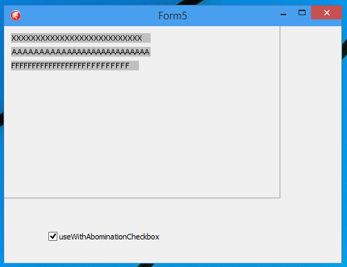

procedure TForm5.Draw3D1Paint(Sender: TObject; const ARect: TRect);
const
	fontSize: Integer = 12;
var
	s:String;
	textPositon: TPoint;
	myCanvas: TTeeCanvas;
	x,y :Integer;
	if not useWithAbominationCheckbox.Checked then begin
		textPositon := TPoint.Create(10, 10);
		myCanvas := Draw3D1.Canvas;
		myCanvas.Font.Size := fontSize;
		myCanvas.Brush.Color := clSilver;
		printText(myCanvas, textPositon, 'XXXXXXXXXXXXXXXXXXXXXXXXXXX');
		textPositon.Offset(0, 20);
		printText(myCanvas, textPositon, 'AAAAAAAAAAAAAAAAAAAAAAAAAAA');
		printText(myCanvas, textPositon, 'FFFFFFFFFFFFFFFFFFFFFFFFFFF');
		printText(myCanvas, textPositon, '... ..');
	end else begin
		x := 10; y:=10;
		with Draw3D1.Canvas do begin
			Font.Height:=-11;
			s:='XXXXXXXXXXXXXXXXXXXXXXXXXXX';
			Brush.Color:=clSilver;
			FillRect(Rect(x,y,x+TextWidth(s),y+TextHeight(s)));
			TextOut(x,y,s);
			s:='AAAAAAAAAAAAAAAAAAAAAAAAAAA';
			y:=y+20;
			TextOut(x,y,s);
			s:='FFFFFFFFFFFFFFFFFFFFFFFFFFF';
			y:=y+20;
			TextOut(x,y,s);
procedure TForm5.useWithAbominationCheckboxClick(Sender: TObject);
	Draw3D1.Invalidate();
Re: Problem with TGDIPlusCanvas.TextWidth
Post by Yeray » Fri Dec 12, 2014 11:05 am
Hi Jens,
Changing this:
         Font.Height:=-11;
For this:
         Font.Size:=fontSize;
Seems to make your example code to draw the same when the checkbox is checked and when it's unchecked.
jens.mertelmeyer

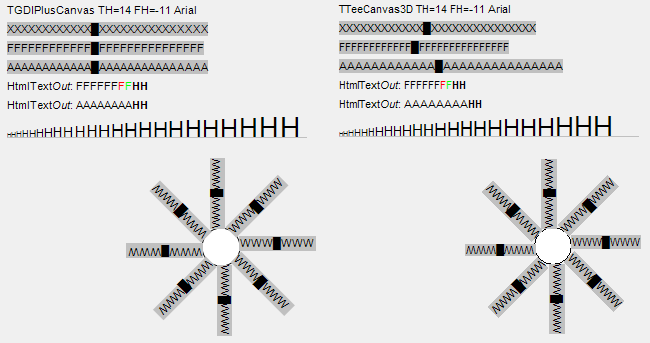

I am a little confused. I have checked the same code with the old GDI Canvas and the buggy result is as follow:
Here the code:
const
  fHeight=-11;
procedure TForm1.Draw3D1Paint(Sender: TObject; const ARect: TRect);
var
  s:String;
  x,y:Integer;
  x:=10; y:=10;
     Font.Height:=fHeight;
     TextOut(x,y,ClassName); y:=y+20;
     TextOut(x,y,s); y:=y+20;
     s:='AAAAAAAAAAAAAAAAAAAAAAAAAAAA';
     TextOut(x,y,'FFFFFFFFFFFFFFFFFFFFFFFFFFF<b>HH</b> ',True); y:=y+20;
     TextOut(x,y,'AAAAAAAAAAAAAAAAAAAAAAAAAAA<b>HH</b> ',True);
procedure TForm1.cbGDIPlusClick(Sender: TObject);
  if cbGDIPlus.Checked then begin
    Draw3D1.Canvas:=TGDIPlusCanvas.Create;
  end else begin
    Draw3D1.Canvas:=TTeeCanvas3D.Create;
    TCanvasAccess(Draw3D1.Canvas).FontQuality:=fqDefault;
In the source code I can find in VCLTee.TeeGDIPlus the lines:
  FGraphics.MeasureString(St,Length(St),FGPFont,TeeZeroPoint, {TGPStringFormat.GenericTypographic,} tmpBox);
If I remove the comments to use Typographic, the result is better, but not good:
I cannot found your function "InternalTextWidth" in my source code. Is there a new source code version greater v2014.12.140923 ??
Jens

  Result.Width:=0; Result.Height:=0; Result.X:=0; Result.Y:=0;
  if length(Text)=0 then exit;
  NeedGPFont;
  format:=TGPStringFormat.Create(StringFormatFlagsMeasureTrailingSpaces);
  rect.X:=0; rect.Y:=0; rect.Width:=9999999;  rect.Height:=9999999;
  ranges := MakeCharacterRange(0,length(Text));
  format.SetMeasurableCharacterRanges(1,@ranges);
  regions[0]:=TGPRegion.Create;
  FGraphics.MeasureCharacterRanges(text, -1, FGPFont, rect, format, 1, regions);
  regions[0].GetBounds(Result,FGraphics);
  regions[0].Free;
  format.Free;
Function TGDIPlusCanvas.TextSize(const St:String):TPointFloat;
  NeedGPFont;
  if (FontMetric.Rotation mod 90)<>0 then with CalcTextRange(St) do
    Result.x:=Round(Width+X*2-FontMetric.OX)  //Approximation
    Result.x:=Round(CalcTextRange(St).Width);  //Excat Textwidth
  Result.y:=FontMetric.TextHeight;
Function TGDIPlusCanvas.TextWidth(const St:String):Integer;
  Result:=Round(TextSize(St).x);
Function TGDIPlusCanvas.TextHeight(const St:String):Integer;
  Result:=Round(TextSize('').y);
Procedure TGDIPlusCanvas.TextOut(X,Y:Single; const Text:String);
var
  Origin : TGPPointF;
  matrix : TGPMatrix;
  tmpBack: TCanvasBackMode;
  Origin.X:=X; Origin.Y:=Y;
  NeedGPFont;
  matrix:=nil;
  FontMetric.Rotation:=(Round(ITextRotation)+360000000) mod 360; //0..359
  if (FontMetric.Rotation<>0) then begin
    matrix:=TGPMatrix.Create;
    if FGraphics.GetTransform(matrix) = Ok then
       if matrix.RotateAt(FontMetric.Rotation,Origin) = Ok then
          FGraphics.MultiplyTransform(matrix);
  case TextAlign and (TA_RIGHT or TA_CENTER) of
  TA_RIGHT: Origin.X:=Origin.X-TextWidth(Text);
  TA_CENTER: Origin.X:=Origin.X-(TextWidth(Text) div 2); //avoid half pixels
  case TextAlign and (TA_BOTTOM or TA_BASELINE) of
  TA_BOTTOM: Origin.Y:=Origin.Y-TextHeight(Text);
  TA_BASELINE: Origin.Y:=Origin.Y-FontMetric.BaseLine;
  tmpBack:=BackMode;
  if (BackMode=cbmOpaque) then begin
    Brush.Color:=BackColor;
    FillRect(CalcTextRect(Origin,Text));
  FGPBrush.Free;
  FGPBrush:=TextBrush(Font.Color,Origin,Text);
  Origin.X:=Origin.X-(FontMetric.OX*0.6); //negative Offset
  if (FontMetric.Rotation mod 90)<>0 then Origin.Y:=Origin.Y+FontMetric.OY; //Bug or Feature???
  FGraphics.DrawString(Text,Length(Text),FGPFont,Origin,FGPBrush);
  BackMode:=tmpBack;
  if Assigned(matrix) then begin
    if FGraphics.ResetTransform = Ok then FreeAndNil(matrix);
    FontMetric.Rotation:=0;
Truly, the GDI+ text function are very strange. But the result with the new code is not bad and you can also use the HTML-Out functions with GDI+:
var
  s:String;
  x,y,h,xp,yp:Integer;
  w:Single;
  x:=10; y:=10;
     Brush.Clear;
     h:=TextHeight('-');
     TextOut(x,y,Format('%s TH=%d FH=%d %s',[ClassName,h,Font.Height,Font.Name]));
     h:=h+5;
     y:=y+h;
     s:='XXXXXXXXXXXX█XXXXXXXXXXXXXXX';
     TextOut(x,y,s); y:=y+h;
     s:='FFFFFFFFFFFF█FFFFFFFFFFFFFFF';
     s:='AAAAAAAAAAAA█AAAAAAAAAAAAAAA';
     Font.Style:=[];
     TextOut(x,y,'HtmlText<i>Out</i>: FFFF</b>FF<font color=#FF0000>F</font><font color=#00FF00>F</font><b>HH</b> ',True); y:=y+h;
     TextOut(x,y,'HtmlText<i>Out</i>: AAAA</b>AAAA<b>HH</b> ',True); y:=y+h;
     Font.Style:=[];
     y:=y+20;
     TextAlign:=TA_BASELINE;
     xp:=x; s:='H';
     FillRect(Rect(x,y,x+300,y+1));
     for yp:=6 to 28 do begin
       Font.Height:=-yp;
       TextOut(xp,y,s);
       xp:=xp+TextWidth(s);
     Font.Height:=-11;
     s:='WWW█WWW';
     //TextAlign:=TA_RIGHT; h:=100;
     //TextAlign:=TA_CENTER; h:=50;
     //TextAlign:=TA_BASELINE;
     //TextAlign:=TA_BOTTOM;
     x:=(ARect.Left+Arect.Height) div 2; y:=y+110;
     Brush.Color:=clWhite;
     Ellipse(x-h,y-h,x+h,y+h);
     w:=0;
     while (w<360) do begin
       xp:=x+Round(h*cos(w/180*PI));
       yp:=y-Round(h*sin(w/180*PI));
       BackColor:=clSilver;
       BackMode:=cbmOpaque;
       RotateLabel(xp,yp,s,w);
       w:=w+45;
I hope, I could help you and you can improve your software.
Another problem: Please look to the function TeEngine.TChartAxis.DrawAxisLabel. You define tmpAlign but don't use it. I think, all Axis Labels are drawn with center alignment. The result is not good.
Jens Gr.
Post by Narcís » Fri Jan 23, 2015 11:14 am
Hello Jens,
Thank you very much for your collaboration and many apologies for the lack of feedback from our side.
This needs to be investigated very carefully as it may provide the desired output but also involve performance regressions. MeasureCharacterRanges is more precise but very slow. We need to investigate if we can make some sort of caching to optimize performance and get the desired rendering output.
