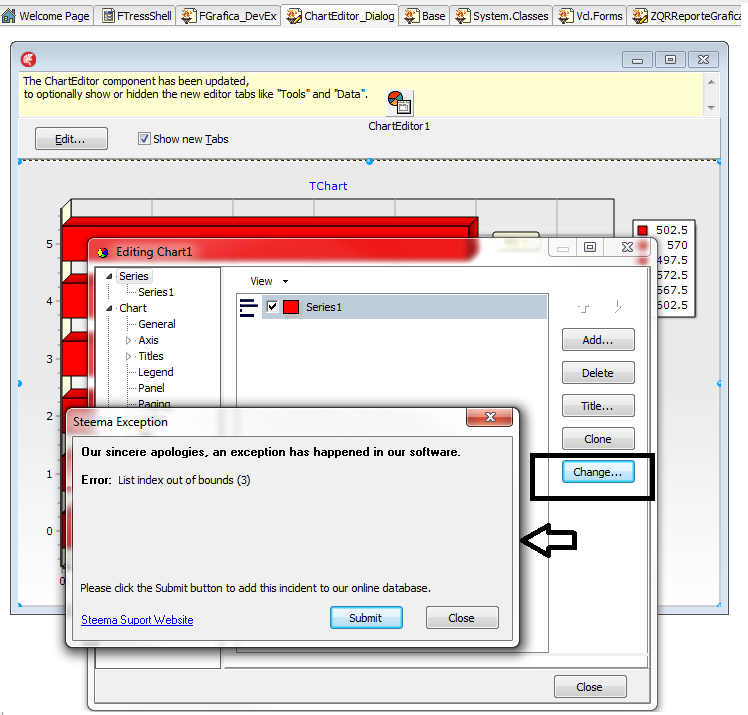

In desing time I was traying to change the default serie in a TChart Object using the TeeChartEditor form, when I tryed to change the serie, the next error message is displayed!
TeeChartEditor Bug
The same behaviour at runtime invocating TeeCharEditor component.

What TeeChart version are you using? It sounds like this:
http://bugs.teechart.net/show_bug.cgi?id=753

Yes thats de problem, We are using the installer TeeChar2014RADXE. I read in the posts that you bring an special exe, Do we need to reinstall teechart? , and where is it? :shock:

The ticket B756 was closed the 2nd June 2014, as you can see in the ticket history.
So, the v2014.12.140923, released the 23th Sep 2014, should include the fix.
What version are you using?
