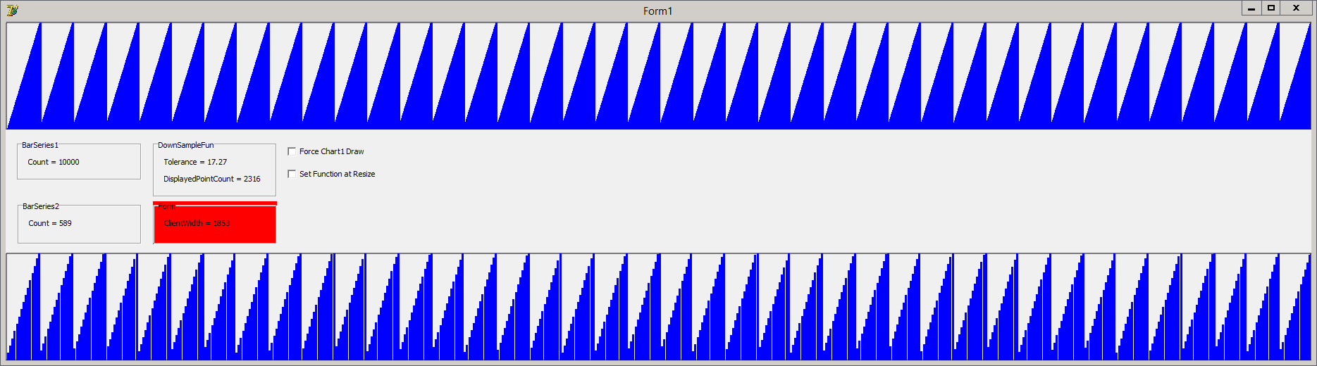

When resizing the form there are still lots of situations where there are more pixels visible on the screen than samples in the chart:
  if ClientWidth > BarSeries2.Count then
    GroupBoxForm.Color := clRed
    GroupBoxForm.Color := clBtnFace;
(The GroupBox will color red)
This isn't always visible in the sample application because the barwidth is more than 1 pixel. In my application the barwidth is 1 pixels.

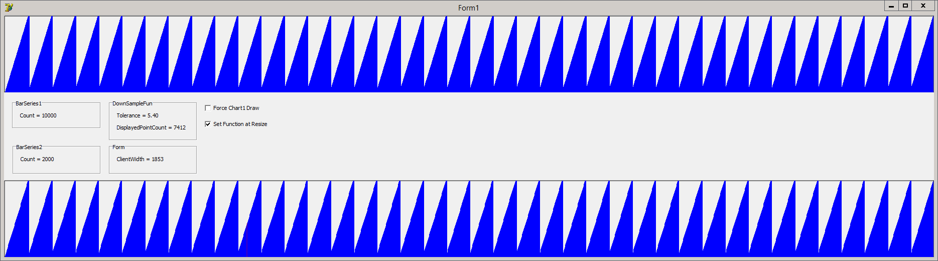

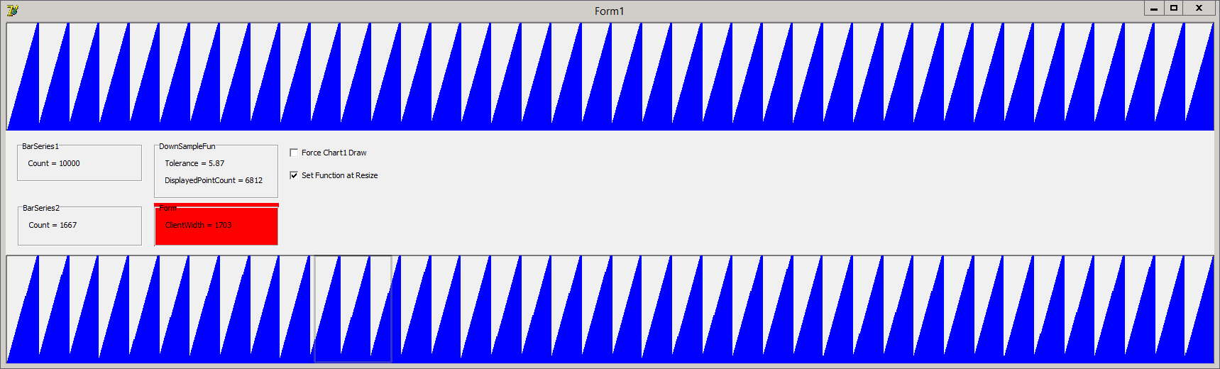

I could see the problem now consistently resizing the application I sent you to more than 1800 pixels width:
I've seen it can be fixed if you recalculate and reset the function Tolerance and DisplayedPointCount properties according to the current width (activating the new checkbox in the revision of the test application):
Now, I can see the box is still red for some widths, but the series always seems to look good:
TeeChart_DownSampling_rev2.zip
(2.45 KiB) Downloaded 586 times

I saw that you added these lines to the sample project, but the bars are still 3 pixels wide. You can also see that in the screenshots you posted.
Yeray wrote:Did you find a different behaviour in a previous version of TeeChart where you found that was the behaviour to expect?
There is no difference between the 2011 version and the 23-09-2014 version, they are both incorrect. (Using Delphi XE7 Professional)
When resizing the form BarSeries2.Count jumps from 589 to 625, etc. Take a look at the table below:
