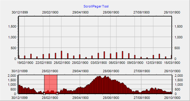

I have just installed the latest September update to TeeChart. I would still like to use the TeeScrollPager Tool but still have numerous problems doing it at design time.
Is there any step by step instructions on how you do this at design time?
Having failed to this at design time, I thought I would try to do it in code, but the example in the "Tee Chart Pro Examples" applications is no help because since it was written the method of doing it has changed far too much. So simply by creating a new project and dropping a chart on it and then copying the code from the example does not work.
Do you have a simple real-world example project that uses the TeeScrollPager tool working from code that does work?
I gave up when I couldn't get this working last time and simply linked too charts together, but one of the reasons I bought the latest version of TeeChart was to use this tool and save me the time and effort.

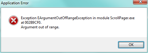

I keep running into exceptions when I run this simple example after trying to add a TeeScrollPager at design time. I'm obviously missing something here but the chart looks good in the IDE why doesn't it just work at run-time?

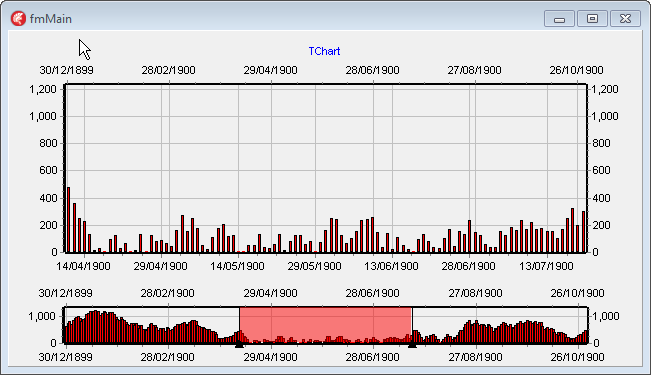

This is what the form looks like in the IDE.
This is the code - most of its commented out because I would like to get it working from the IDE and not code.

xmetman wrote:I keep running into exceptions when I run this simple example after trying to add a TeeScrollPager at design time. I'm obviously missing something here but the chart looks good in the IDE why doesn't it just work at run-time?
Solved this "Argument Out Of Range" exception changing the TScrollPagerTool's DivisionRatio in the dfm from 4.000000000000000000 to 3.000000000000000000.
Then, running your application I get this:
I add this code to move the colorband:
  ChartTool1.ColorBandTool.StartValue:=Series1.XValue[50];
  ChartTool1.ColorBandTool.EndValue:=Series1.XValue[75];
And it works fine for me here:
The ColorBand is undraggable and unresizable, but if you remove the AllowDrag and AllowResize line in your dfm inside the SubChart, then you can drag and resize the colorband on it:
