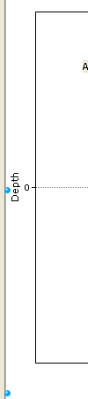

I believe that with the latest 2014 version there has been a change in the starting position of the Y axis label. As you can see from the images in earlier versions the label was centered to the middle of the axis length but now it looks like it starts from that point.

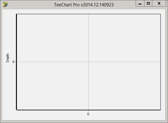

In TeeChart v2014.12 indeed, the label looks a bit displaced:

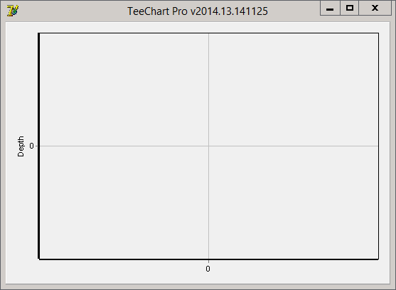

But in the current internal sources, it looks correct again:
So I'd expect this to be fixed with the next maintenance release.
