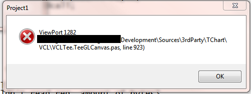

whenever I call the draw procedure of a OpenGL TChart I get an error message:
ViewPort 1282, VCLTee.TeeGLCanvas.pas, line 923
Just execute this code on a TChart (MyChart) in OpenGL mode:

X-Ray wrote:whenever I call the draw procedure of a OpenGL TChart I get an error message:
We could reproduce the problem here.
I'm afraid we are finding problems to draw a Chart directly to a bitmap using OpenGL.

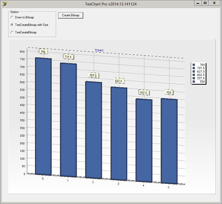

The technique described above seems to work fine for me with v2014.12 even if I hide the TChart.
Here it is an example showing 3 techniques: Drawing directly to the TBitmap (crashes), using TeeCreateBitmap passing the desired size to it (crashes) and using TeeCreateBitmap without arguments but modifying the TChart size before and after that call as described above (it works).
GLtoBitmap.zip
(2 KiB) Downloaded 1073 times

You are right, I forgot the the Chart.Draw call.
When I include this call before calling Chart.TeeCreateBitmap it works fine.
Thank you !
