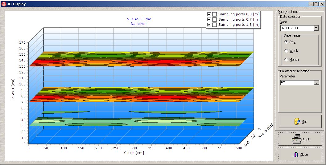

Hi all,
I'm having a hard time displaying a 3d-Graph with several contour plots. I added a sample with random data.
This shows the plot as it should pretty much look like in the end, but what I really need is queries for each
layer (along z-axis).
Now my questions:
a) I can connect the series to a query at design time and at run time, but nothing shows
b) how can I define the size of a contour area in the plot? (I place it on the z-axis with
setting "YPosition", the other dimensions I set with the NumXValues and NumYValues
property, which makes the series expect 60000 values, but I have only only ~100)
c) I'm very confused with the 3D Grid's range and palette properties. What are they meant for?
I would like a "red light-like" color transition for small concentrations to large concentrations.
Thanks for any suggestions
Norbert

llnck wrote:a) I can connect the series to a query at design time and at run time, but nothing shows
You may be missing to open the database or the query.
llnck wrote:b) how can I define the size of a contour area in the plot? (I place it on the z-axis with
Usually, the increments of the XValues and YValues are always 1 so they are typically populated as follows:
  for i:=0 to 2 do
    with Chart1.AddSeries(TContourSeries) as TContourSeries do
      Brush.Style:=bsSolid;
      NumXValues:=10;
      NumZValues:=5;
      for x:=0 to NumXValues-1 do
        for z:=0 to NumZValues-1 do
          AddXYZ(x, random*10, z);
      case i of
        0: YPosition:=30;
        1: YPosition:=70;
        2: YPosition:=130;
  Chart1.Axes.Left.SetMinMax(0,170);
  Chart1.Axes.Depth.Visible:=true;
However, if you want, you can set IrregularGrid=true and use a different increment. Ie:
  for i:=0 to 2 do
      IrregularGrid:=true;
      XCount:=12;
      ZCount:=8;
      XMax:=600;
      ZMax:=100;
      for x:=0 to XCount-1 do
        for z:=0 to ZCount-1 do
          AddXYZ(x*XMax/(XCount-1), random*10, z*ZMax/(ZCount-1));
      case i of
        0: YPosition:=30;
        1: YPosition:=70;
        2: YPosition:=130;
